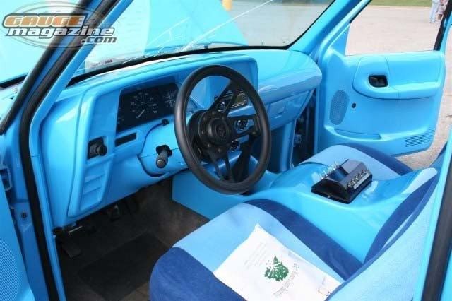

I decided i may use my stock dash and want to eliminate some holes on the dash. It is a vinyl dash and i want to know whats the best was to eliminate things such as defrost vents, etc. Should i scuff it and lay the matte down or is there another option? I dont want to peel the vinyl off. Something like this one, stock dash smoothed out.

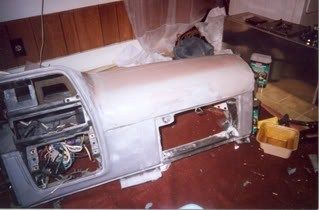

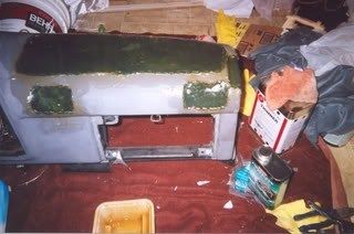

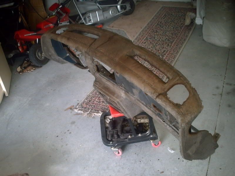

I've never tried that, i would think the expansion and contraction of the filler would make it crack. Here are some build pics to give you some ideas. After the short strand body filler, i used Plastiflex by Evercoat to cover everything. It's a little pricey but i can punch my dash with no worries of it cracking.
