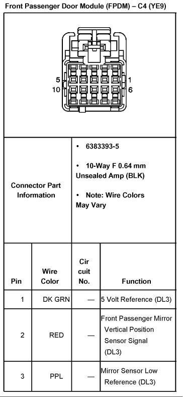

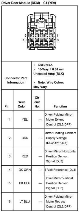

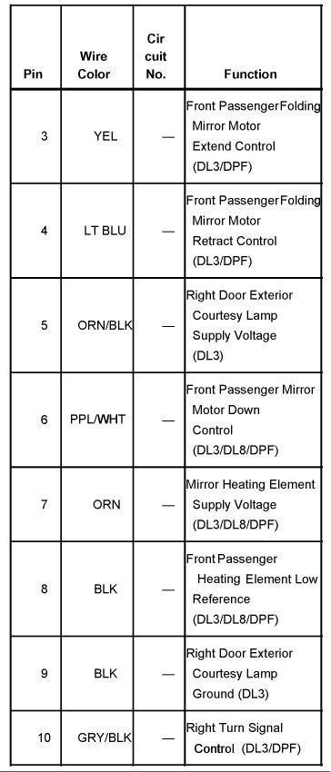

Does anyone have a link to the schematic for the power mirrors for this truck? I added after market mirrors and need the wiring info. Thanks

No terry. I thought they would. I have done two other trucks like this and this is the first time I am running into this. The stock mirrors did not have a harness to unplug either. The stock mirror plugged directly into the door panels.

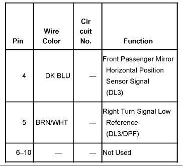

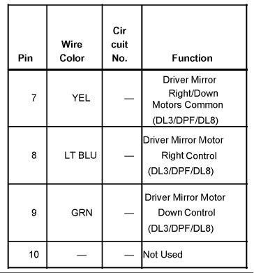

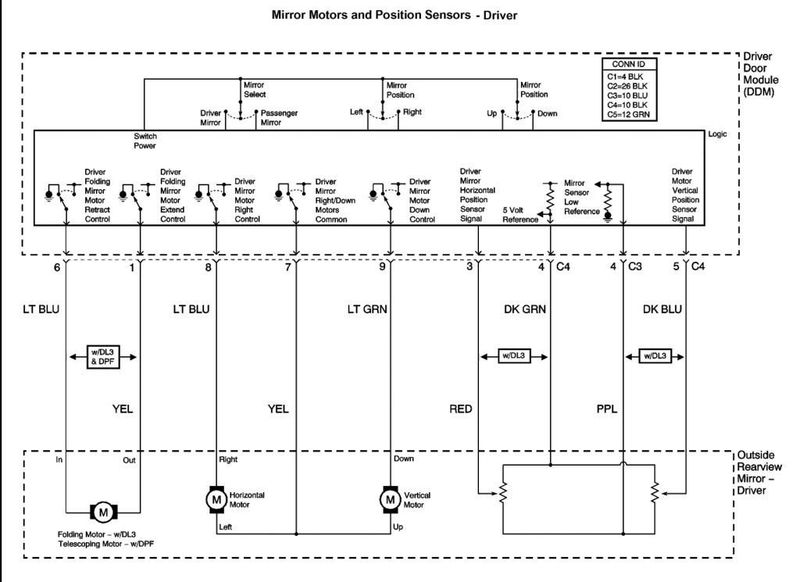

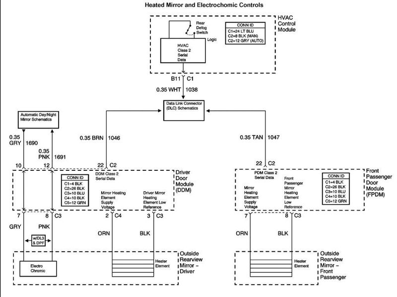

LayedOutChevy
post photo post photo post photo post photo post photo post photo post photo post photo post photo
Y
YOLO
Tavo. Your the man. Thank you.
