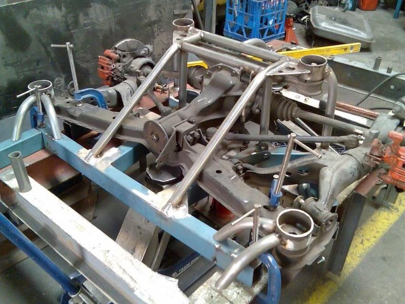

Here is the rear subframe for a 4 runner on 20's in Australia. This might help a bit.

i bought my rear clip about 3-4 years ago from larry echols at innovative air, he had a jig set up for making the rx7 clips...so i really dont know exactly how it was set up at what height and so forth..but i can tell you that its set up nearly identical to the way corey's is...with the only difference being my subframe is about in inch or two higher than his..im going to post aired up and aired out pics tomorrow so u guys can see how far this is moving

a T-Bird or Mark VIII IRS both use long arm short arm setups similar to those used in a front suspension setup.....Supras also use a multi arm setup but its a little more confusing of a setup.....here are pics of my Mark VIII IRS setup from my 4runners frame
