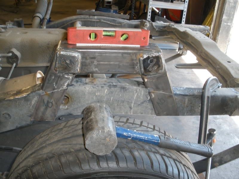

I like box tube notched better on C-Channel frames. If your frame is fully boxed, you will have an easier time with an 8 pc kit. Anything on the market now will be plenty strong. Just make sure you fully weld it all. I think SDs are 3/16 side plates and 1/8" top and bottom caps. No need to go any thicker than that.
outlawcrewcab's avatar
outlawcrewcab
we build 3x3 box tubing notches for full box frames then trim the front and back of legs so they will slide down over the frame, weld them in, the box in the open part on back
