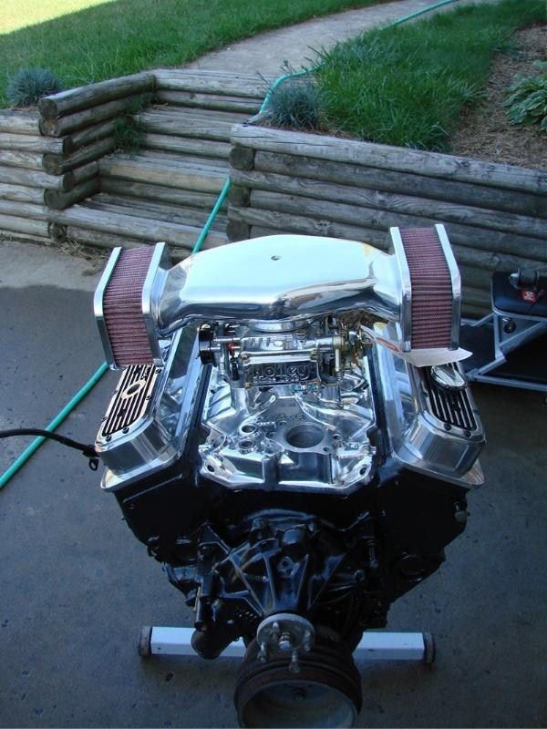

well in the process of doin this on my girlfriends s10. i had to get new intake, and distributor. and of course the carb got it all from summit.
pic of her motor so far

what about a wiring harness?
east*coast*nomad's avatar
east*coast*nomad
well if you are just switching to carb there are only a couple wires you need. but im having a guy i work with wire up the truck sooo no big help to ya there.
