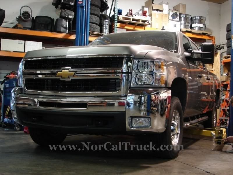

The Day I left it

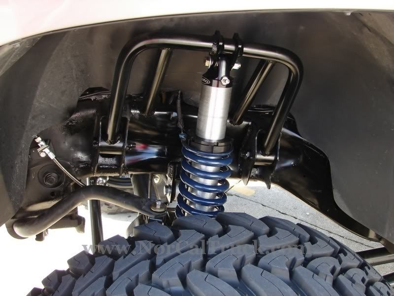

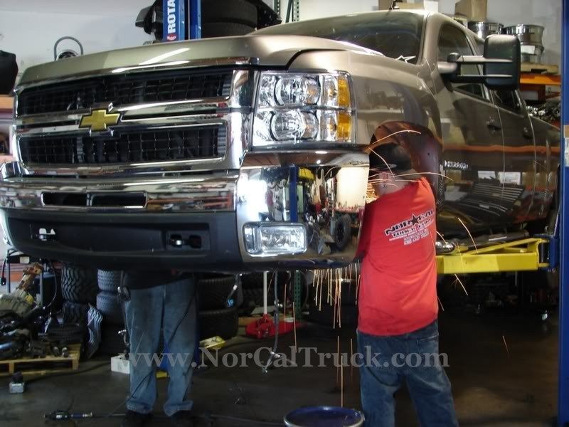

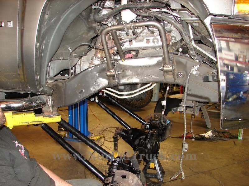

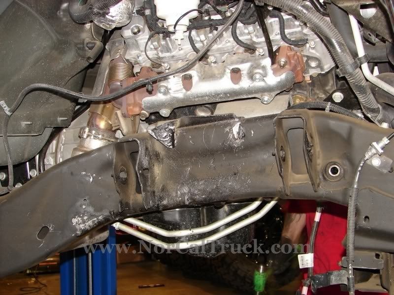

Hanging axle and installing shock hoops

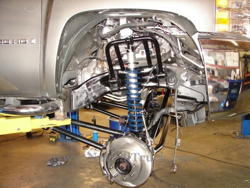

Setting at full drop on coilovers
Shot of coilover on the ground

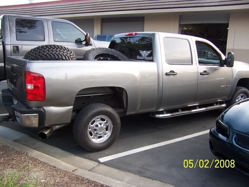

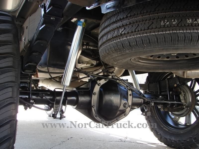

Rear Shot

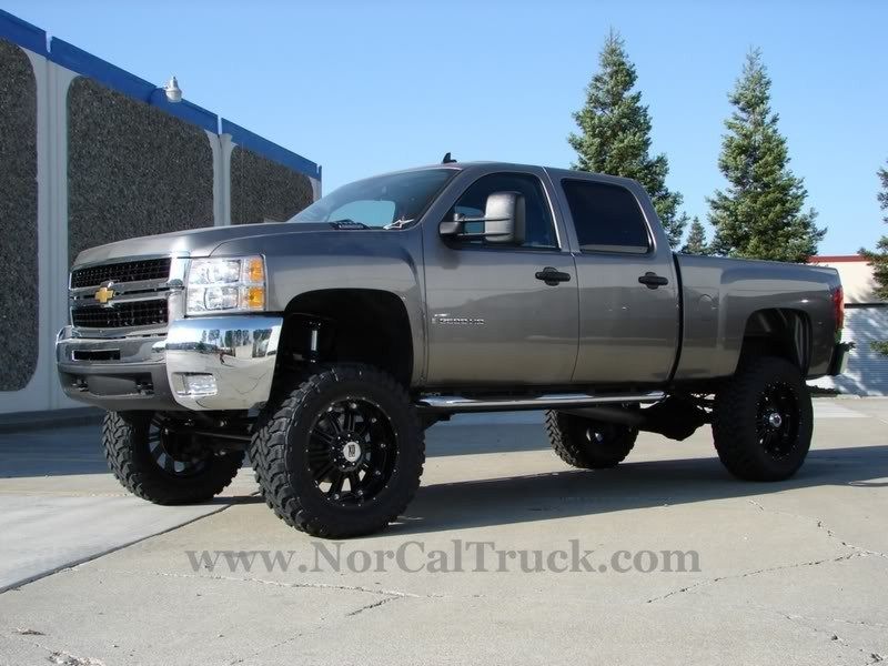

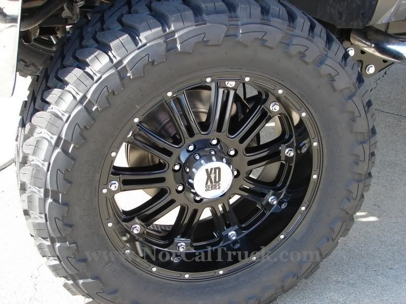

Wheels 37" toyo MT's on 22" Black KMC HOSS Wheels
Sitting Pretty

Rear Shot

Looks good. I gotta ask tho, why is the front coil hoops bolted and welded on?
looks to me as they just used the factory control arm brackets cuz they were already there and welded the top. guess that was easier than takin everything off the frame completely and startin from scratch.
jus my .02
but the truck looks sick!
down4bmx
jus my .02
Good Observation Guys, Basically thats the way pure performance made the kits for easier installation for the avaerage joe. my goal after I get my 3" kings for this thing is to ditch that cheezy shock hoop and build a custom one thats completly welded on...
