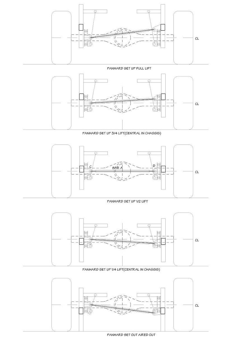

im runnin a reverse 4 link on my mazda b2200. does my panhard have to run the full length of the rear end or can i have it go to just the center of my axle?? i only have enough room to go to the center from my c notch.

Its going to shift side to side more than if you ran it the full lenght of the rearend.

so the panhard should go full length of the rearend?
phatedscustoms
yes sir for the best results it should run the full length of you rear end. or as long as you can possible make it.

Of course as long as possible is best, but if you don't have room, halfway will work fine. Just be sure to set it up properly. There have been a few threads on here about how to do that and I wrote and article for Sport Truck a few months back that has some good info as to how to do that.

Revised drawing to suit what Max said
I hope this is right this time.

It looks good, but at half travel the rearend should be pushed over half of the total side movement. Only at 1/4 and 3/4 travel will the rearend be centered in the chassis.
