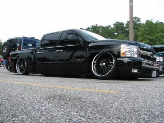

Trying to find out if he had to shorten the axel to tuck those rims... If anyone has any info or more pics besides the ones on mautofied it would be great.

http://i264.photobucket.com/albums/ii194/AcrophobiA26/2007silverado.jpg
not sure how to post pics.
AcrophobiATX
Or any other 07-08 silverado or Sierra that is just bagged not body dropped, i know the body dropped ones have shorten there axels.

Check out this link, its not the same truck but it follows a build on the same body style.
http://lowboymotorsports.com/site2/gallery/view_album.php?set_albumName=2007-CHEVY-QUAD-CAB

i didnt have to shorten the axle at all. they are 24 x 10s. i think like a 25mm offset. cant remember exactly. no trouble with them tucking.

i cant really tell in the build pics if the rear end has been shortened but i dont think it was. Im runnin a boss 313 22x9.5 with a 265/35/22 tire, its in the shop as we speak getting bagged just trying to see if they are going to have to shorten the axel or notch the fire wall which i dont want to do either. Thanks for the help guys keep it coming.
