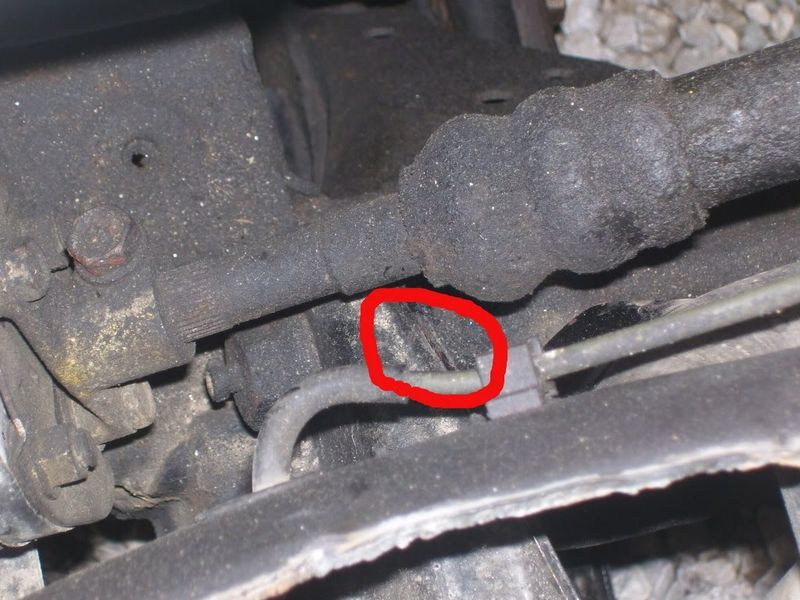

did you look and see if the upper arm is hitting the steering shaft? happens when you lower mazdas a lot

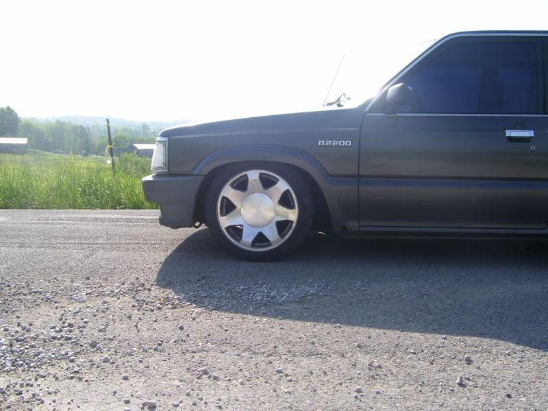

I didn't check that. Here's a pic so you guys can see my ride height. It feels like it understeers, and then oversteers in curves.

Yeah I just moved the balljoints instead of actually "flipping them." I have tapered lug nuts. I tried different ones til I found ones that seat good in the rims. I bought the truck completely stock and it's alway driven kind of weird. But after I replaced the tie rods, balljoints, pitman, and idler and lowered it some more it seems to have aggravated the problem. I went out and looked at it after you posted about the upper c.a. hitting the steering shaft and it looks like it has a little but not much. There aren't any marks on the shaft but you can see on the c.a. where it's rubbed. As soon as my wife gets back with the camera I'll snap some pics to see if you can see anything. It rides good, plenty of travel but the steering is horrible.

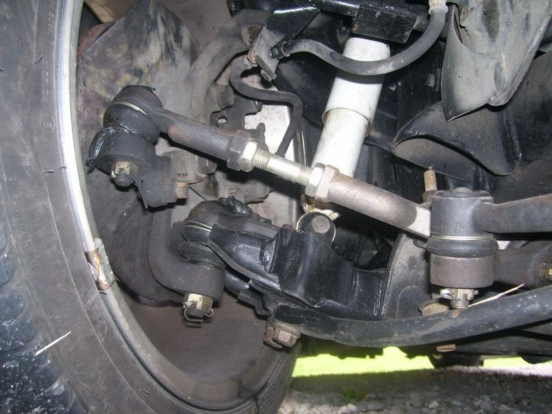

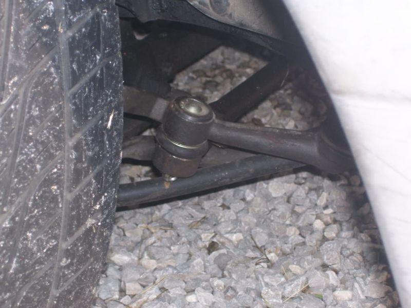

Here's the passenger side with the wheel cut all the way to right. You can see were the idler arm is rubbing the strut rod.

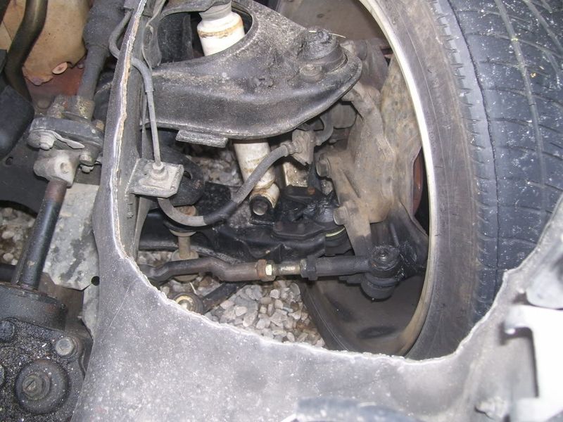

Here's were the upper c.a. has rubbed the steering shaft. You can hardly tell but it's there.

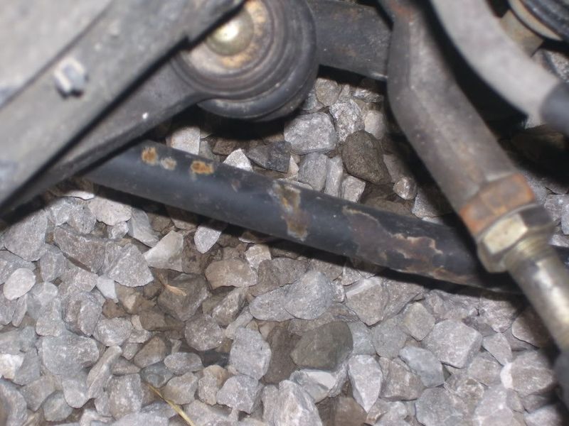

Here's what I was saying about the shock looking like it's leaning.

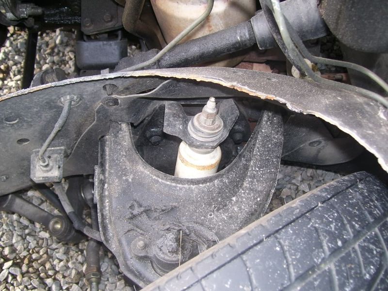

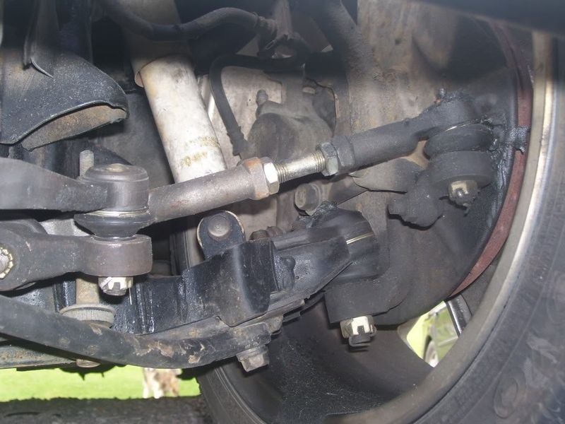

Here's some shots of the driver's side with the wheel cut all the way to the left.

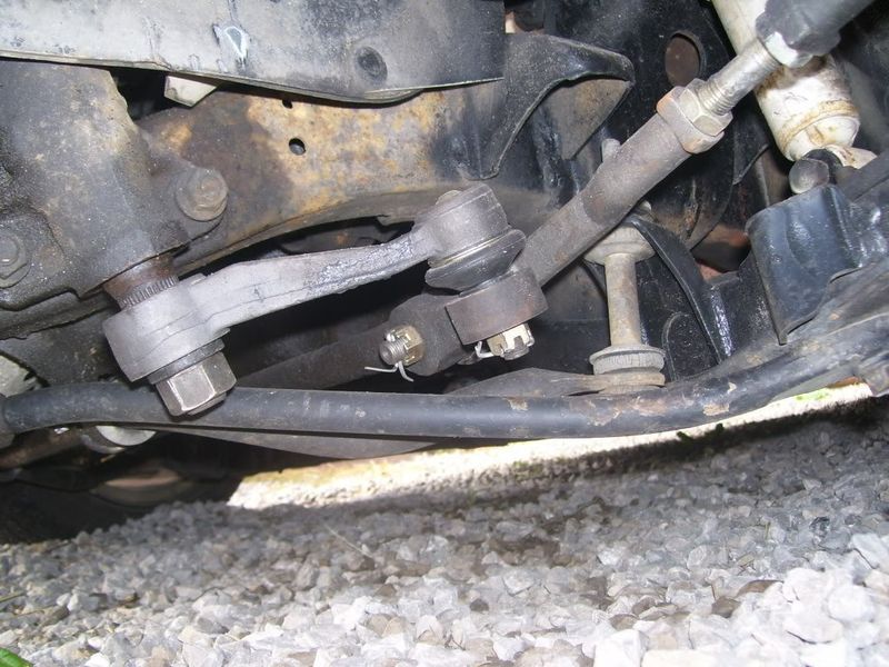

Here's where the pitman has been rubbing the strut rod.

Thats next on my list to check. I'd say triangulating my lowers and doing away with the strut rods would help too. I'm sure strut rods were never meant to handle this angle. I wonder if that might be why my shocks look like they're leaning? When I had it aligned he sad the caster was good though. Maybe my lower control arm bushings are bad?
