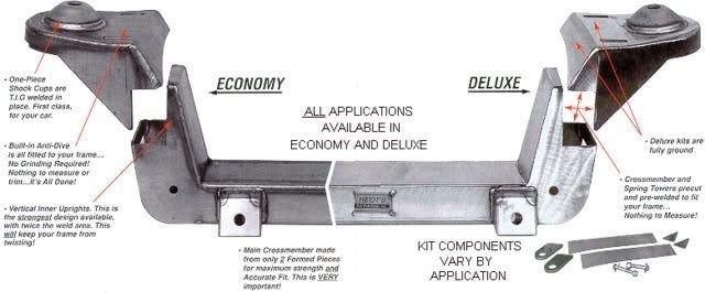

If you look at most MII kits one of the rack mounts is slotted. Probably because one side varies, and one is a constant for most racks they use.

Since I can't sleep, because this is driving me nuts, I decided to do some homework on this stuff. I found lots of pics of Mustang II crossmembers and the bolt holes are not centered. I'm going to assume that a newer mustang rack mounts the same. If I take the tie rod ends off and measure tip to tip that sould give me the center of the rack to line up with the center of the vehicle...correct?
