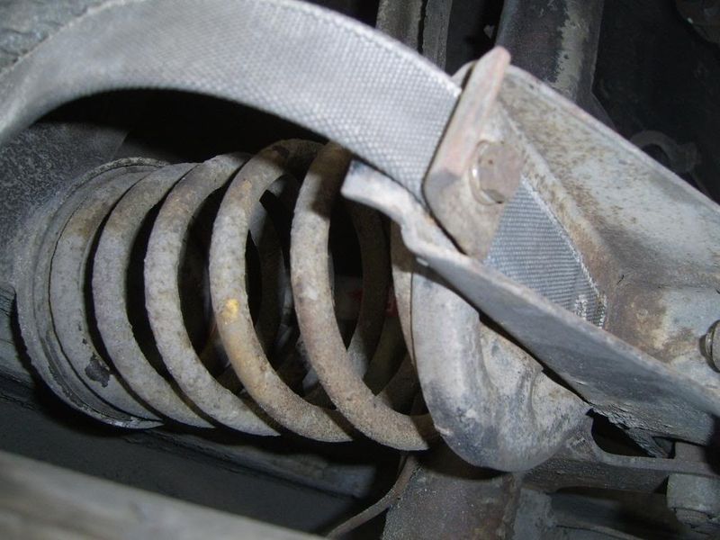

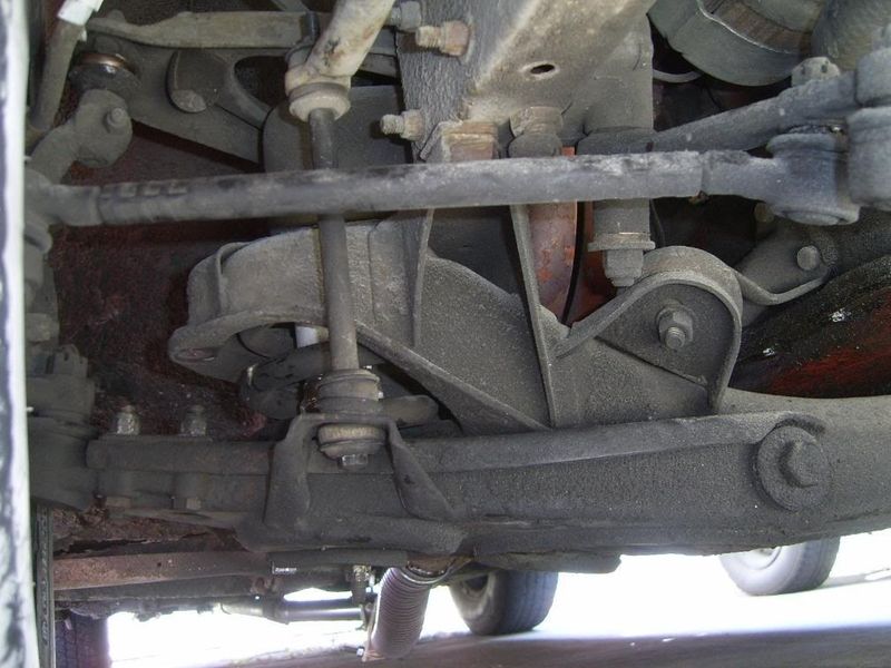

Anyone familiar with the suspension on one of these things??

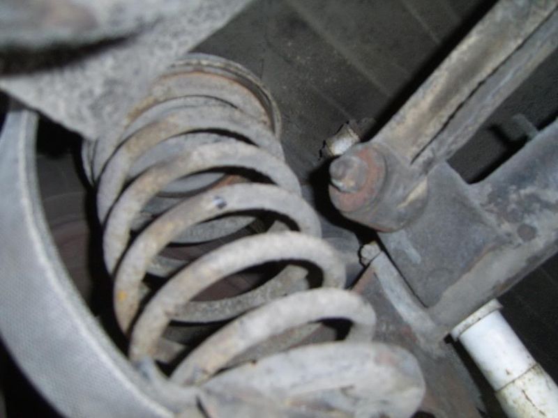

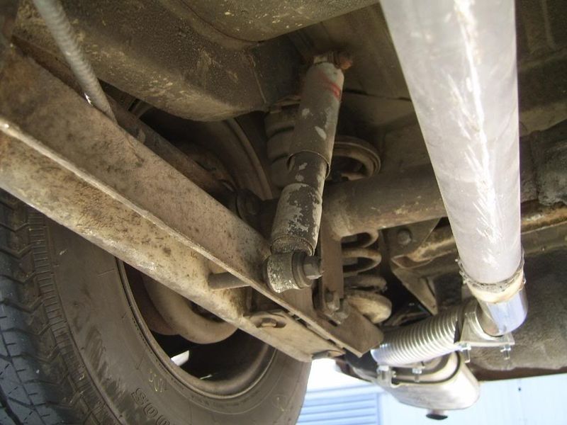

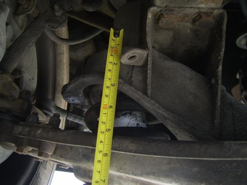

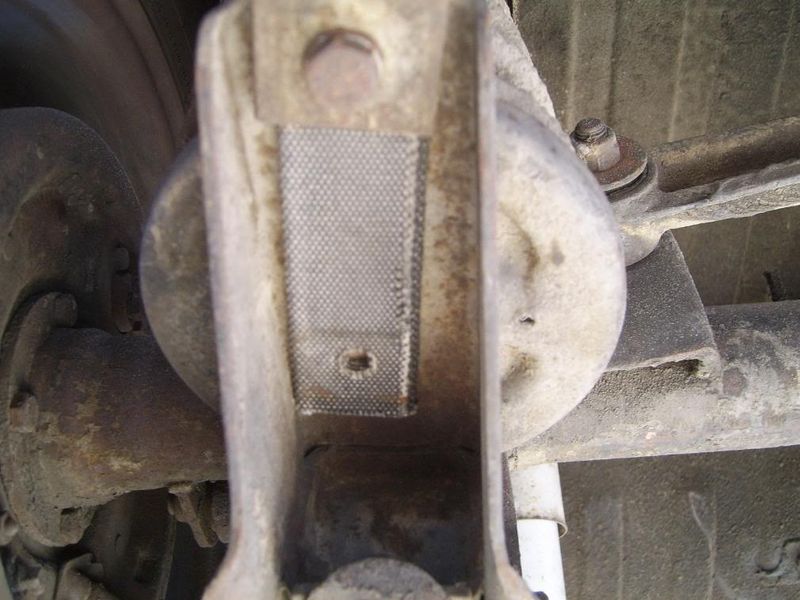

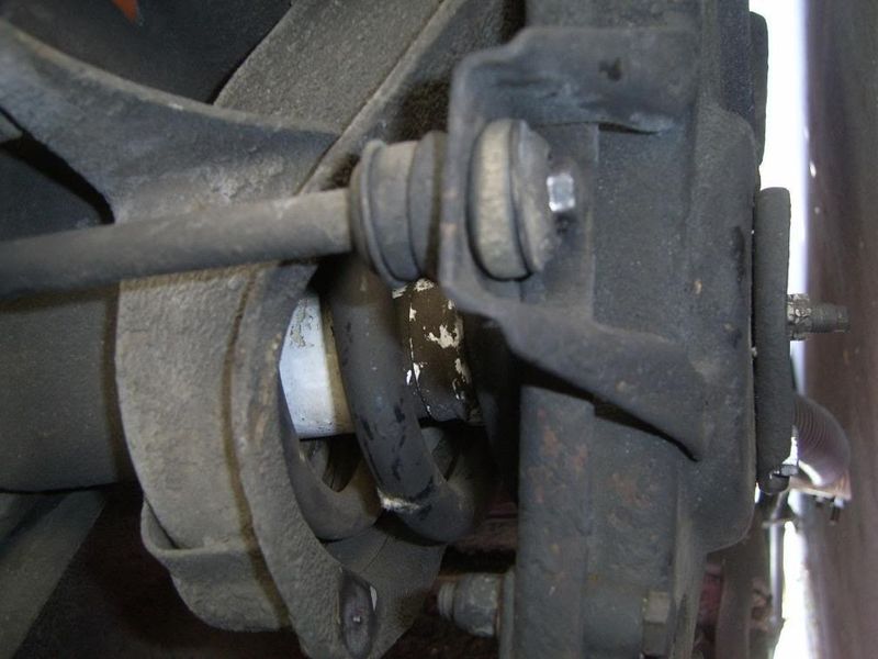

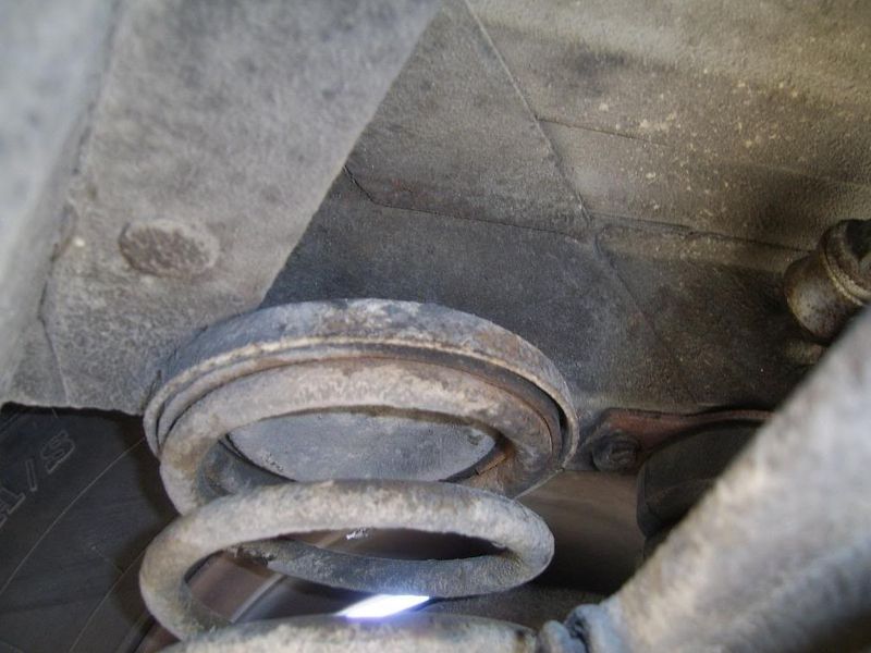

Here are some pics, looking for suggestions for bagging it..
backs
fronts

looks like sleeves in the rear and some cutting up the front to make room for 2500's in the front, those front spring pockets look big enough for a simple placement..
after peaking at the rear, since its a dead axle why not just do a triang four link with bags in front of axle unless you want to use the stock spring mounts. It looks like that pan bar is gonna cause some clearance problems
