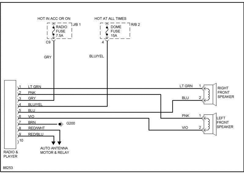

my boss got a double din radio (casette/radio-cd below) unit from a late ninetys toyota, and wanted me to put it in one of our work trucks, does anyone know which wires are for constant power, ground, and ignition? thanks....

toyota what? gimme specifics and ill get u waht goes to what.
TwistedPhil's avatar
TwistedPhil
What a lucky day for you- I just put a deck in a Yota today!
Gray and Blue with a Yellow stripe are the two hot leads- I'm not sure which one is constant and which is ignition, since they are wired together on my install.
Brown is Ground.
Front speakers are Pink (+) and Purple (-) for one side, Mint Green (+) and Blue (-) for the other.
Hope that helps!
-Phil

you probably figured it out by now, and i know phil helped already, but here is my contribution...i miss my toyota...0.o
TwistedPhil
His is better!
