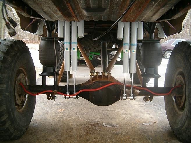

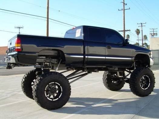

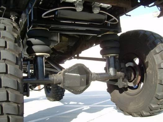

I did this one a few years ago. Theres a few more pics in my profile.

Thanks Guys, That helps alot! I was looking to build something alittle more complicated then those setups. Not just 4 inch pipe and weld a plate on top hehhee...
If you dont mind me asking, How does the Heims hold up. I would think after some miles they will get some slop in them...
I was thinking like super pivot's of something for mine....

I've had Heims in my Nissan for 7 years with no problems. They use them in offroad trucks all the time, desert trucks, CORE trucks, so they must stand up to the abuse. Just make sure you get good ones.

Holy sugar titties batman
That blue f/s is sick...
Those 1/2" tabs look good on that axle too!

Awesome, I was just curious.... What size heims did you end up doing on that? 1"

To add to it... What kinds of bags are on that truck diesel bags? if so whats the brand...
