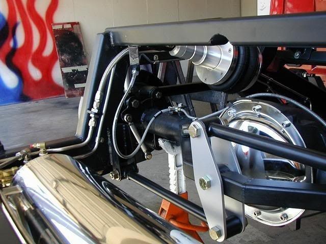

3/8 is awhole lot easier to bend then 1/2, you can also get tighter bends with 3/8.. i had good luck with my swagelok fittings rated up to 5000psi no leaks at all.
