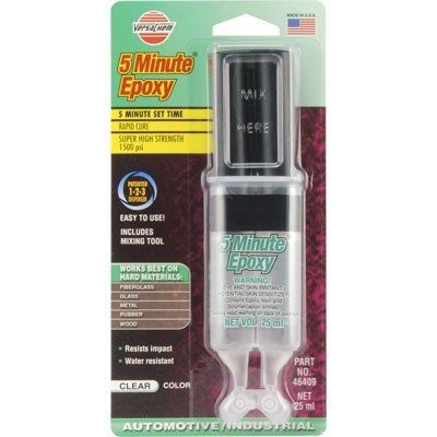

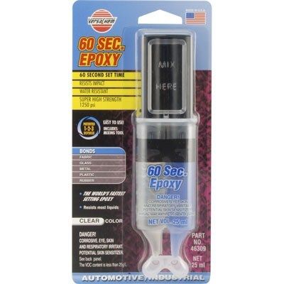

I know its an old thread, which epoxy would use if I just went down the Autozone?
Thishttp://www.autozone.com/autozone/accessories/ITW-Performance-Polymers-25-ml-syringe-crystal-clear-5-min-epoxy-system/_/N-25y6;jsessionid=029669E5D34D644F7940C7401B32E9E6.diyprod4-b2c8?counter=0&itemIdentifier=417321_0_0_
Or this one
http://www.autozone.com/autozone/accessories/ITW-Performance-Polymers-25-ml-syringe-clear-60-sec-epoxy-system/_/N-25y6;jsessionid=029669E5D34D644F7940C7401B32E9E6.diyprod4-b2c8?counter=7&itemIdentifier=417320_0_0_
Or can someone point me in the right direction?
