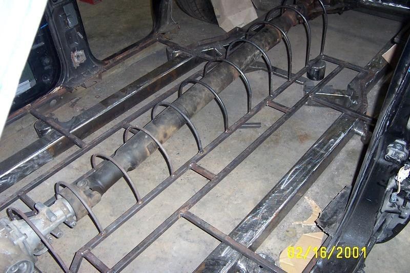

I wanted to know about a sfbd on a 95 blazer. if i use 2x3 for the frame, how much am i gonna have to modify this driveshaft tunnel? I am just going to lay rocker on 20's so my main concern is keeping the rear seat. Is it going to be better to do an underslung frame or a traditional notch and cover? i have 3 kids so i have to keep room for the back seat! any help would be wonderful! Sorry im ocd gotta have everything planned out and calculated before i start! its not a good job if its not done right!!

heres one we did.
able to still use the back seat, but he chose not to.
granth
is that a parallel setup......or would it be a tri 4?

Am I going to have to custom fab seat mounts? Or can I get by with using the stock ones? Plus will I have to notch to use a 4 link or would it be better to use the bars on the rear, with a wishbone? Well actually I would have to use them on the front cause I wanted to use the rear mounting gas tank so there would be no tank dragging issues!

its triangulated, it just looks alittle different because of that angle.
heres some better pics
its what we call "Fuck Square Lower Bars" , 4 link kit. lol

my blazers frame is 'underslung'... but theres still no way we could've ran a stock backseat (not sure if you have a 2 or 4 door). The tubs were one issue, on 22s - and we built the floor from scratch to keep it as low as possible. I know scrapin' customs (florida?) had a red stock floor 4door that I THINK kept the back seat?... maybe somebody else can scrounge up some pics of it.
