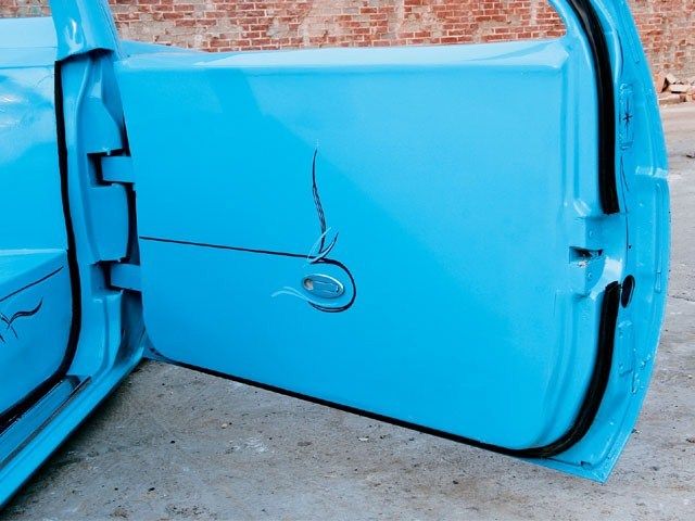

Something like this truck, but im pretty sure these are just fiberglassed on, it would suck if he ever had to do anything inside the door...

On my Mazda I used sheetmetal and bonded it to the stock panel so it kept all the holes for the clips. Then we smoothed it all out so there was no lines to seperate the 2 pieces. I dont know if your are a similar style. Hope this helps.
