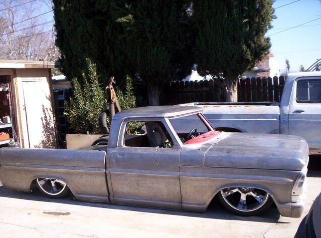

I have a mustan 2 setup in my truck and I extended my uppers 1 1/2" and not had any problems.
slammedxonair's avatar
slammedxonair
Edited: 3/28/2008 2:26:17 PM by slammed x on air
do you have any pics of the chassis or the truck at full lift? and also, are you mounting points the normal points and you just extended the arms? or did you move the uca mounts as well? thanks
nice truck by the way!
