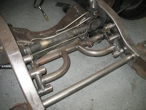

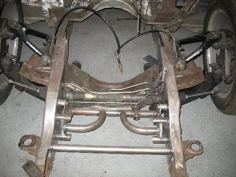

Porterbuilt sells em with there new croassmember but u can order it seperate. Another option would be a custom built one from "Flaming River"
porterbuilt
The design of the factory C-10 crossmember makes it extremely difficult to fabricate mounts for a rack and pinion, that would locate it in an ideal position. It can be done, but requires some knowledge in suspension and steering geometry, along with sound fabrication skills. This is one of the many reasons that helped give birth to the Dropmember.
We use a Mustang rack from 79-93 model years, but our system is designed to be used with this rack's dimensions. The Dropmember's geometry is not the same as factory C-10.

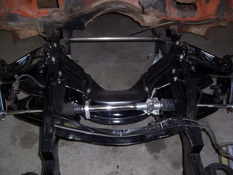

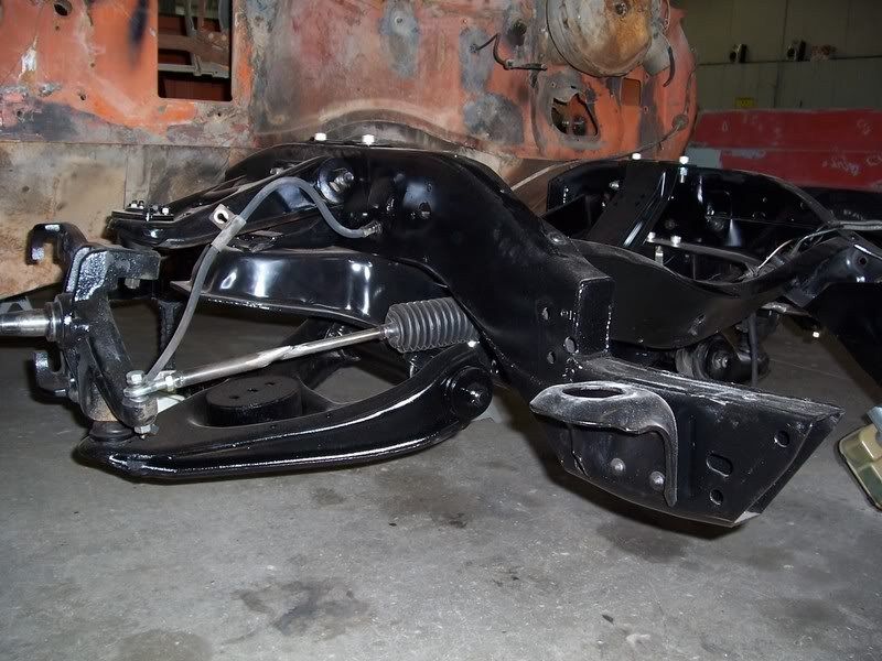

I put a rack on the front of my 76 crew cab

Pinto rack, billet mount and tie rod extensions from jegs then I drilled out the spindle and machined a bronze bushing and pressed it in for the bolt to go through.

Ive done a few of them like that....
