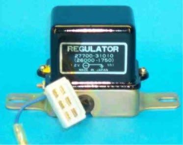

Does your alternator have an internal or external voltage regulator? If external, that could be the problem...

lucky_brew's avatar
lucky_brew
did you buy a piece of shit made in a 3rd work country by little kids alternator from autozone? if so, the new one could be bad too! anyhoo, the voltage regualtor should be on the fender well with a battery lead going to it... here is a pic of it
