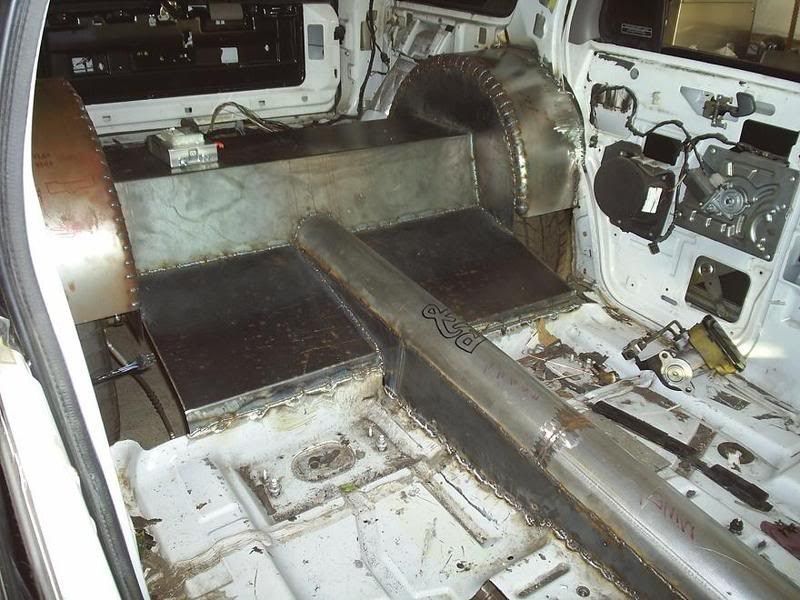

Good luck is all I can tell you. I am having to redo my whole rear floor to make room for my suspension. Here is a pic out of another tahoe...

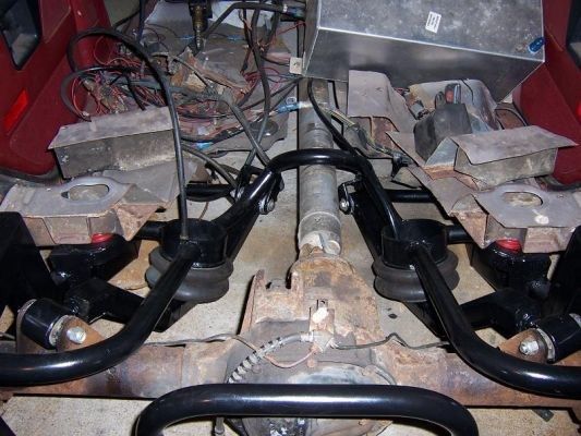

This is the set-up in my blazer if you look close you can see the upper bars are bend i think its only like 20 degrees but it made a hugh difference on how much lower i could put the floor pans. I highly recommend running bent bars to keep as much floor as possible cause for me its all about comfort!

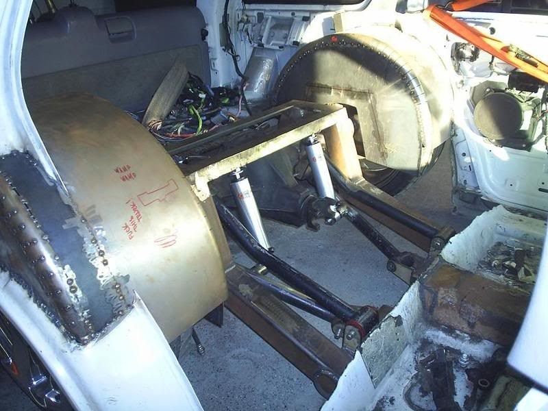

and this is with the floor in. Id say i still have a good amount of room in there for seats and what not compared to many other suvs
