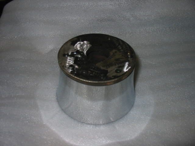

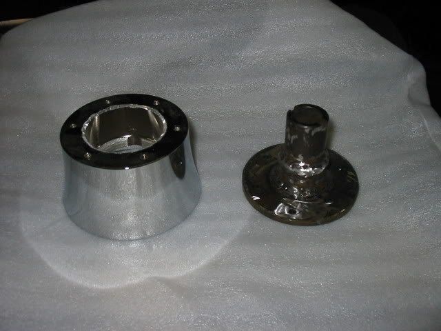

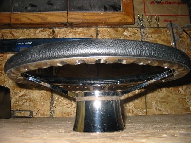

I couldn't find one, i thought I did but it didn't work. what I did was cut out the mount from the middle of my stock steering wheel. Then I made a flat plate/mount for it. Welded the two together and added a few inches to get the steering wheel where I wanted it. Then I got a steering hub for a fullsize chevy, cut out the middle of so my mount would go thru the middle. heres some pics. The flat part has 6 holes drilled and taped so the screws thru the steering wheel hold it all together.
hope that helps, if you want more pics or help let me know
heres is the stock center hub, plate and the extra few inches I addes to the stock hub
here I cut out the middle of the chevy hub
the pieces together
and what it looks like when done
DiegosAnotherR1
NICE!!! I liked how that turned out. Looks like an easy task. Thanks man!
