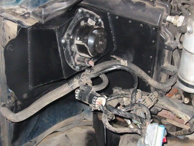

Heres the one Mind To Metal did.. Works good just doesnt blow as hard as stock.

and that pic above is my buddy colemans s10, its for sale right now, 3000 bucks.
