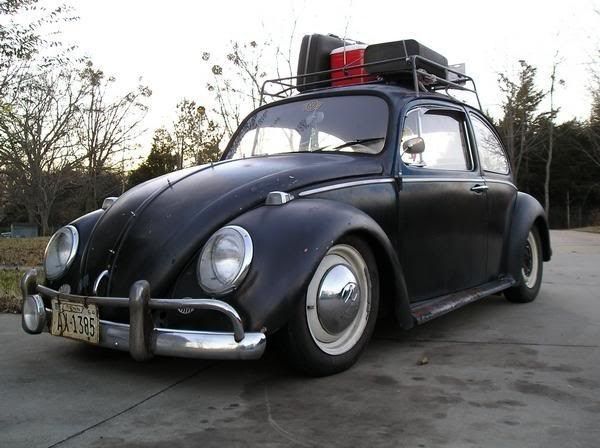

here you go a good Idea on how one looks bagged
pick up a vw trends magazine
they have adds that sell air bag parts
hope this helps on your search

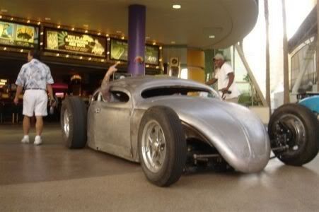

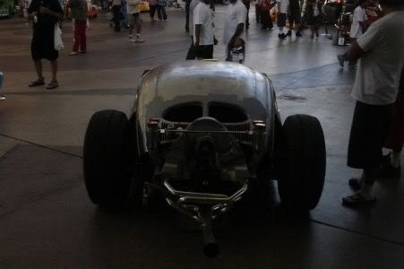

heres mine on the ground it takes more then a narrowed beam

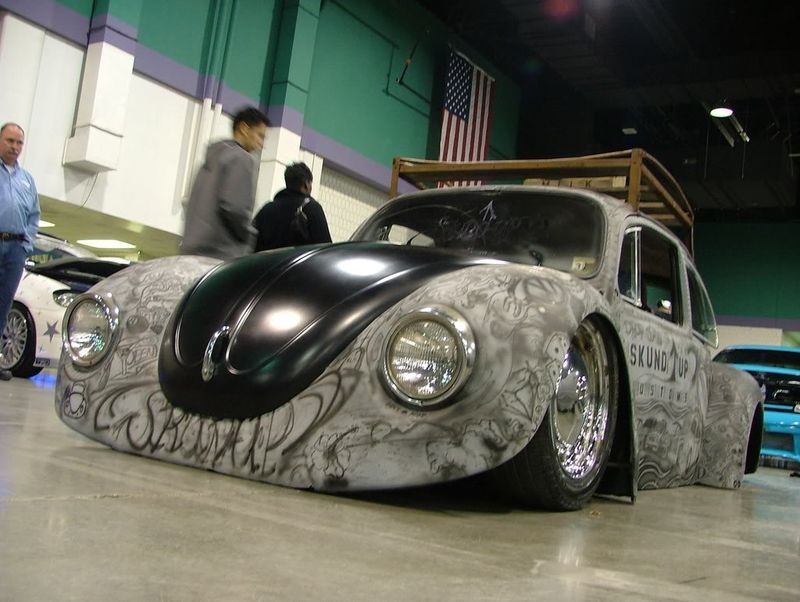

Check out www.volksrods.com some bad stuff on there!

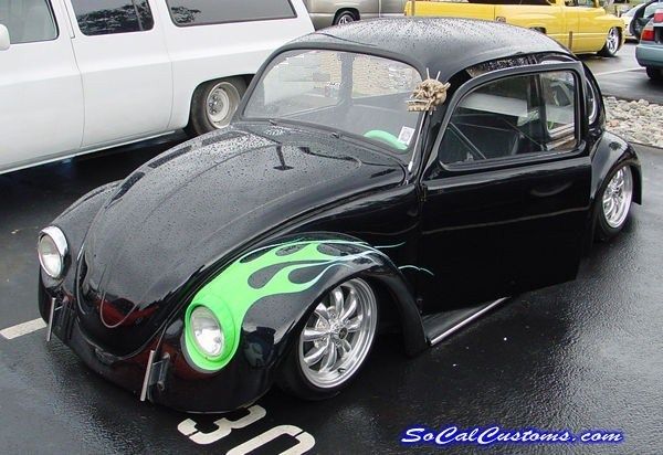

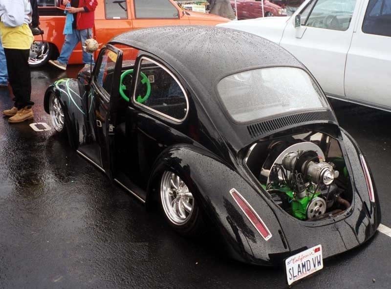

here is my buddies 65 bug with a narrowed beam and spindles. he drags the frt bottom of it very often lol. its got a tall rat rod style flake shifter in it too. it also still rides good, and http://www.thesamba.com/vw/ has alot of stuff for VW's
