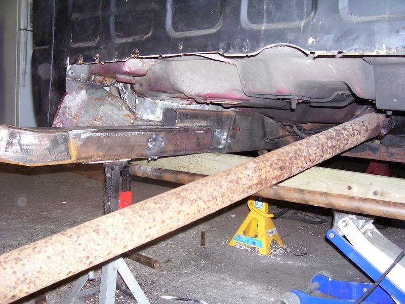

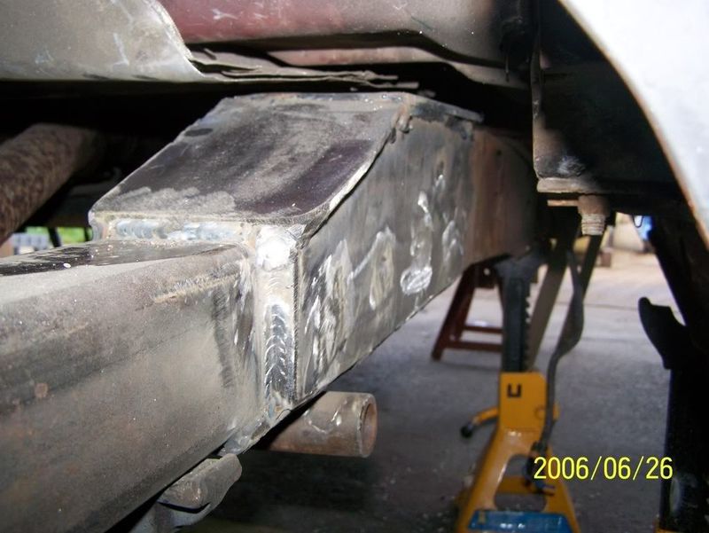

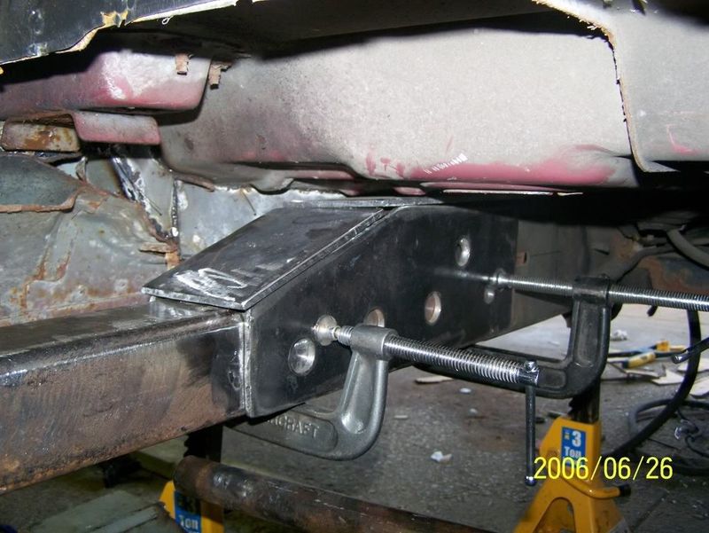

Fraynlame's avatar
Fraynlame
here's what i did. just cut the 3" out of my stock frame and slid my new frame in about 12", welded it and plated it.
