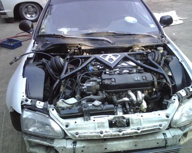

crippled4life
Edited: 2/14/2008 4:43:48 PM by crippled4life
not mine..but like this?
s10
