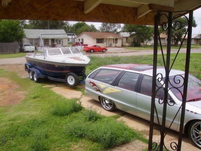

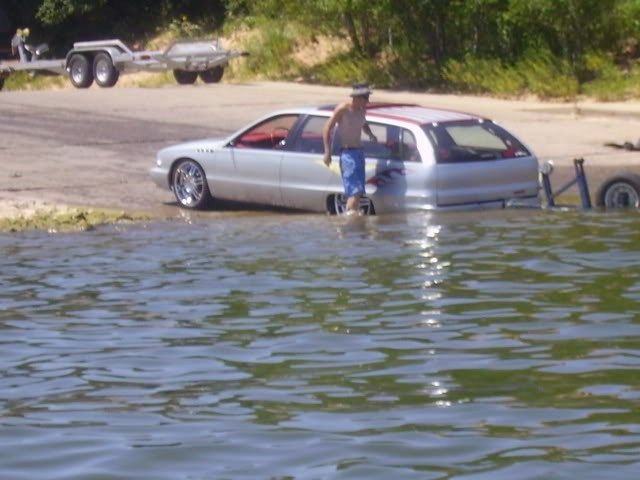

I use 9000's in the rear and have so many times.they work perfect,all you have to do is put a shorter shock in to keep it from over expanding.I know the re8 rides decent but the sleeve rides like a cadillac.I also use them in caprice and wagon applications along with a few other things.Some people say sleeve bags are weak and don't last but ive had them in my wagon for many years without a single problem.I think most problems stem from bad install.
