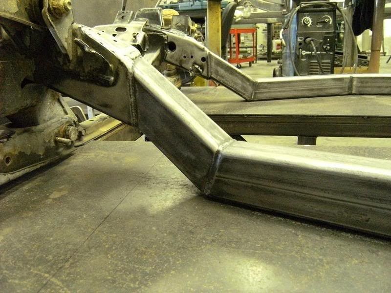

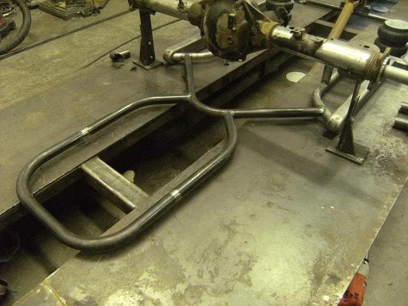

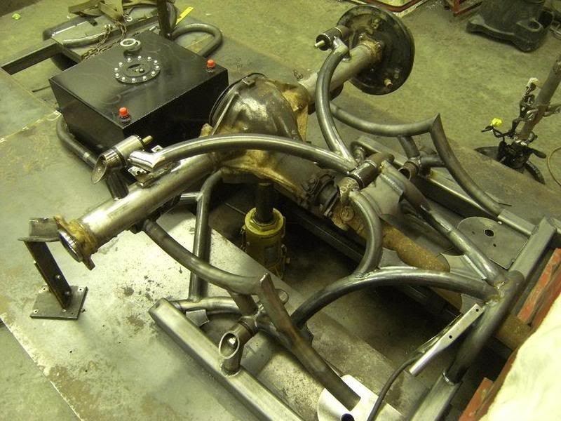

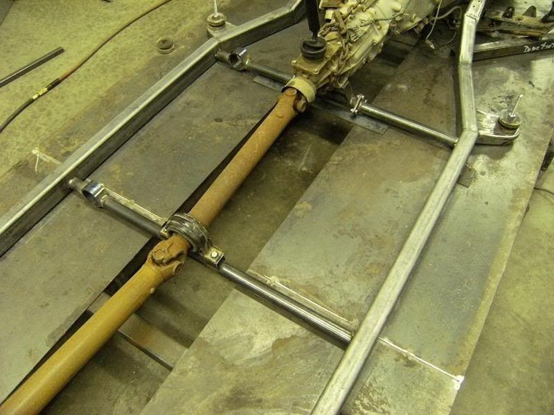

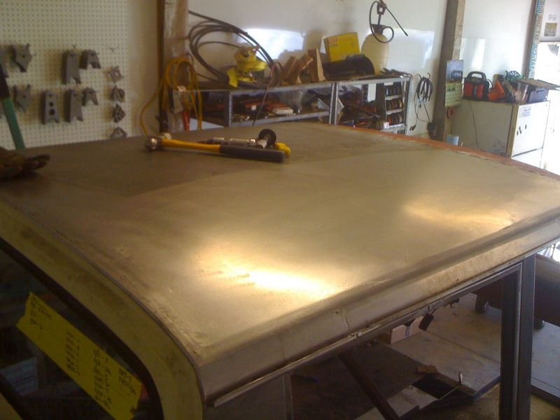

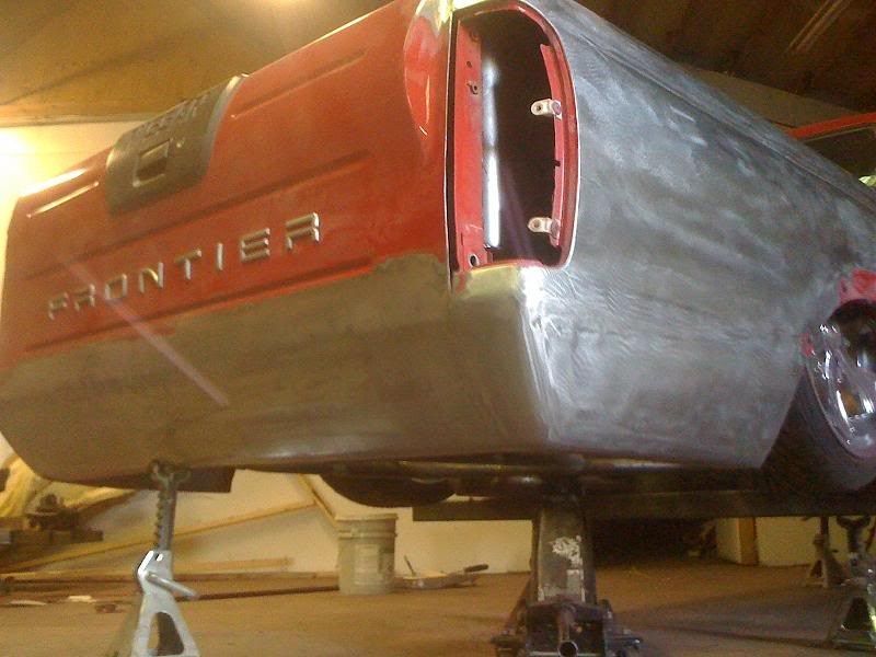

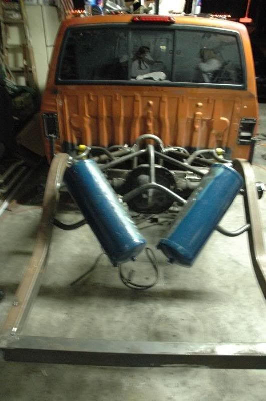

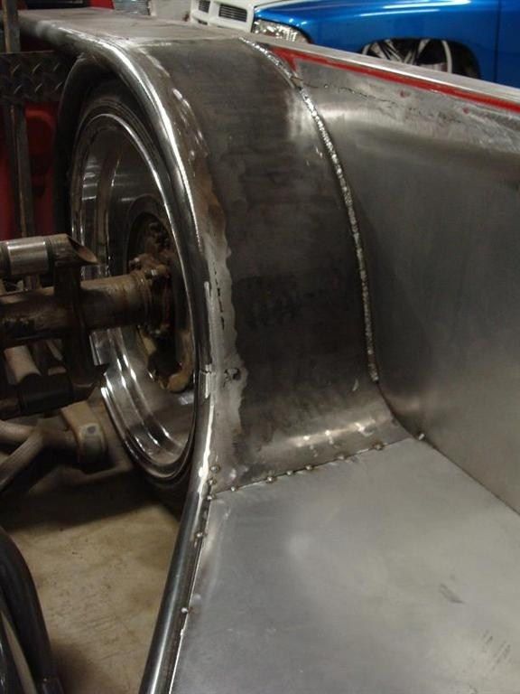

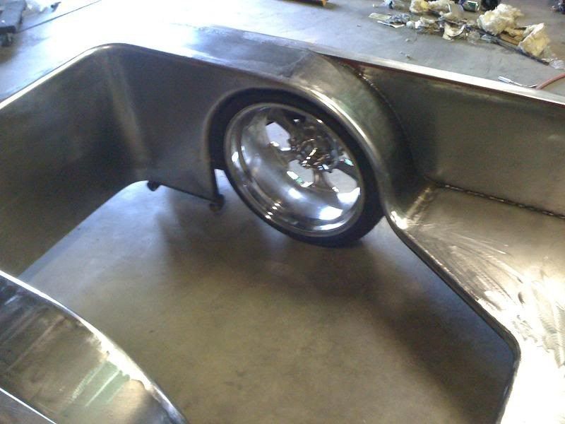

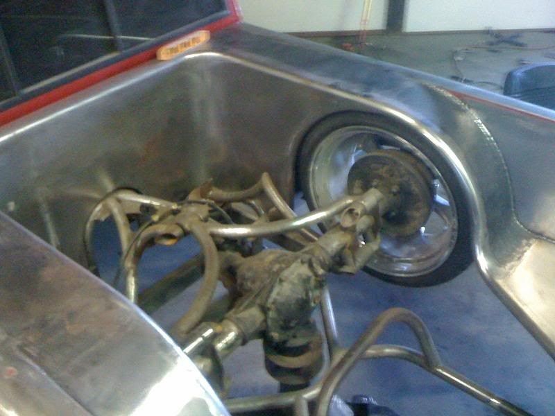

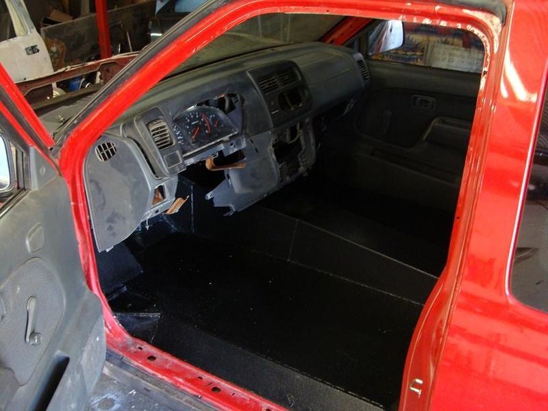

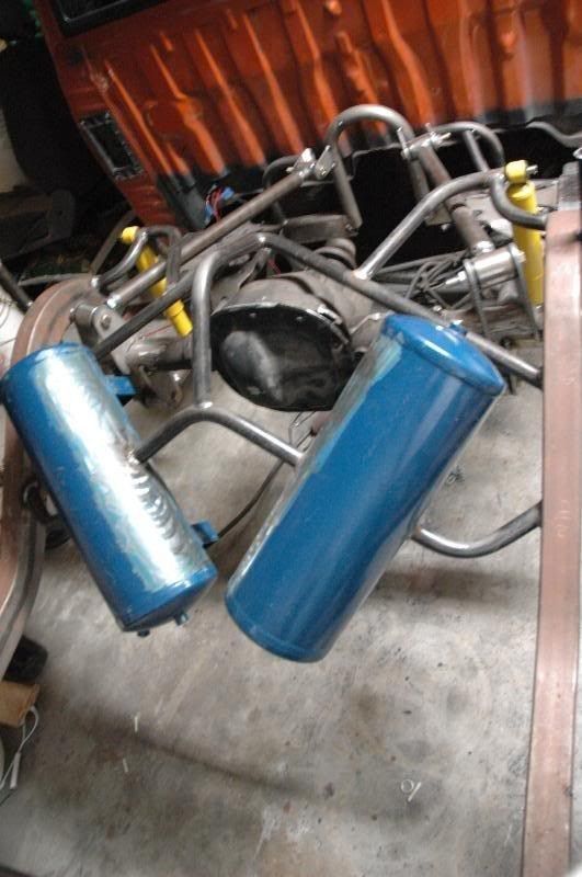

This is a current project i got going on. Its a 2001 Nissan Frontier that came from a friend in Oklahoma. Plans are: cut to the doors (true door) 20''X9.5'' Martin Bros Hammerhead wheels 255/35/20 tires Narrowed rearend 7 3/4'' Custom upper and lower arms flipped drag linkage (helps with toe in) 1.25:1 Cantilever link setup underslung frame smooth sheetmetal floor Modded fenders Thats where it stands as of now. Im having problems with the axles and i need to know if the quadcab rearend is any wider than the standard and x cab.

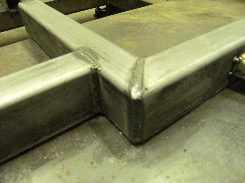

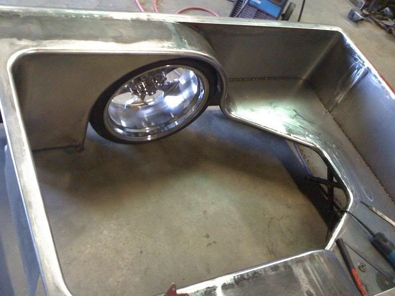

Yay! Seeing something lay true doors can brighten up any room. Nice welds, killer frame work.

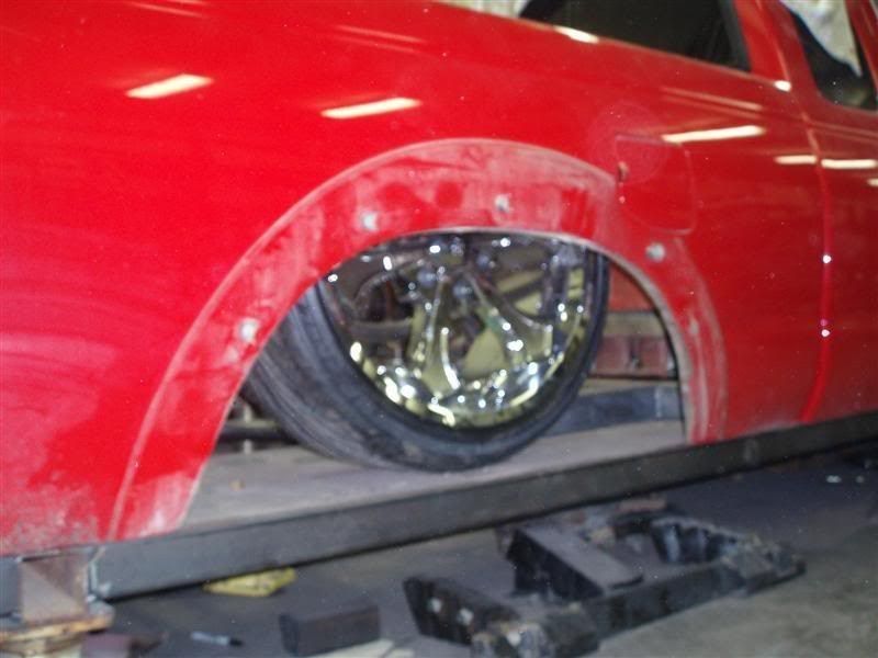

Going to build an entirely new hood with that curve, or just put bubbles over the wheels?
guiltybydesign's avatar
guiltybydesign

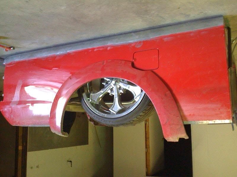

i was gonna just blister the hood but i would have to blister it for the tires, intake, and valve cover so im just gonna make a hood that bows with the fenders.

looks sick. wont comment on the bulge for the wheels until the hood is done. i love frontiers though. so sick.
