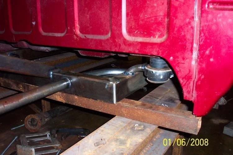

look at the body mount cris did on the "chalky blue" s-10 (scott childress' of no regrets)its in the under construction forums...

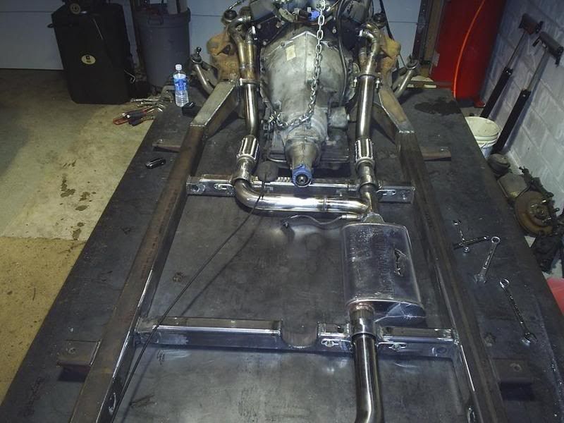

You can kinda see mine in this picture if you want me to take some more pictures just let me know. There cut out of 3x3 by the way

the pic lucky is talkin about.
