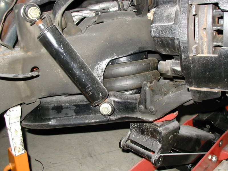

here ya go.I'm runnin 245/40/20 20X8 wheel 5" backspace.
Since this pic I did change how the upper mounts (used D tabs adn turned the mount 90) so there is no (Less) binding through the travel. But the shock is still in the same place.
