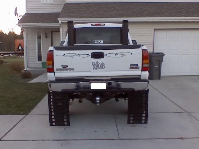

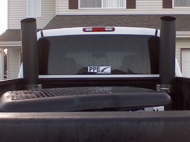

I haven't seen ceramic coating any more expensive then powdercoating, and most shops have plenty of colors, my exhaust stacks a ceramic coated jet black, look great.
SSM-Webmaster's avatar
SSM-Webmaster
Dave, is that a snowmobile track as your mudflaps?
