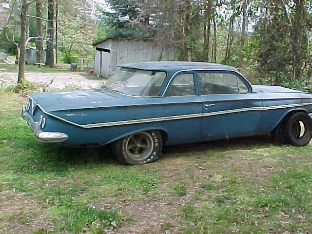

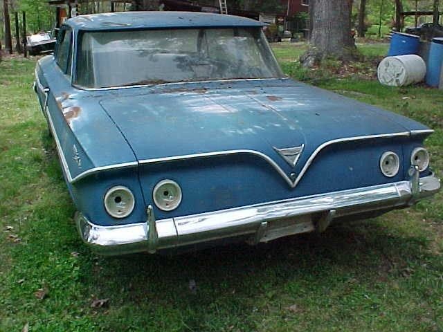

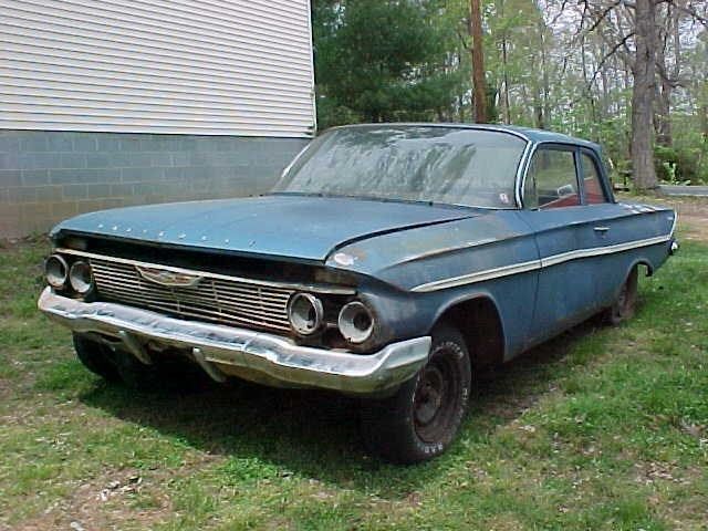

heres how she stands....not bad for $170
