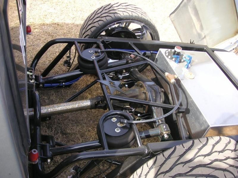

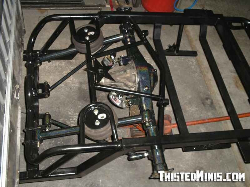

I'm too lazy to look it up, but find the Mazda DIB is doing on 22s. It has bags on the upper bars.
Heres one I did.

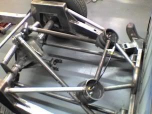

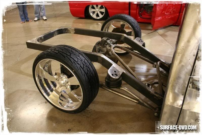

Here are some i found around here..hope no one minds
