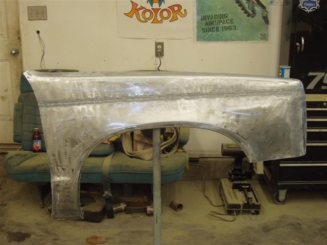

weld it. and yes it sucks. I still have the doors to do. On my 1/4s we hammered the line flat before we put them on but thats not really an option if you arent replacing the panel.

I had mine done with evercoat metal to metal filler before. It eventually cracked. grinding it out of the fenders to do it properly sucked. My doors and 1/4s were already junk so I just got new ones.

Yeah I had stips of 16gauge sheared. i think somewhere between 3/8" and 1/2".

Guess I'd better get the welder warmed up then. There's a kid here in my city that did his with regular Evercoat, it sunk within the first two weeks of driving it, and cracked all to hell. sad part is he paid a guy $4500 to do the body and shave his tailgate. Now it looks like he did it himself with play-doh.

it can be done with bondo hair but i always use round rod welded in the bondo hair.

Yeah canadian temperature change doesn't go well with thick bondo. Where I'm at we see extremes of -35 C in winter to +35 C in summer (-31 F to 95 F).
