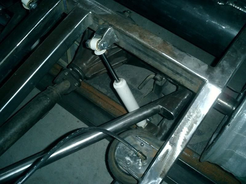

Show me some pics of how and where you mounted your shocks in the rear. I need ideas and suggestions on how I should do it and where they should go.

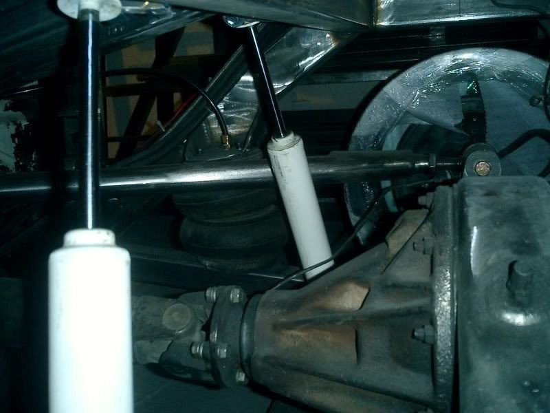

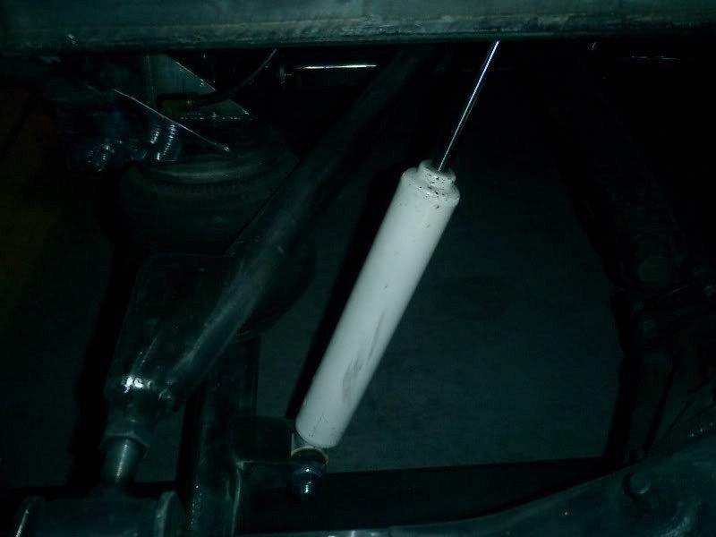

heres some of mine, there not the best, its kind of hard getting pics of them

Umm... you don't expect those shocks to be in one piece in 1000 miles do you?
Mount both ends in the same plane of motion, or you'll be breaking the eyelets off one end in no time.
