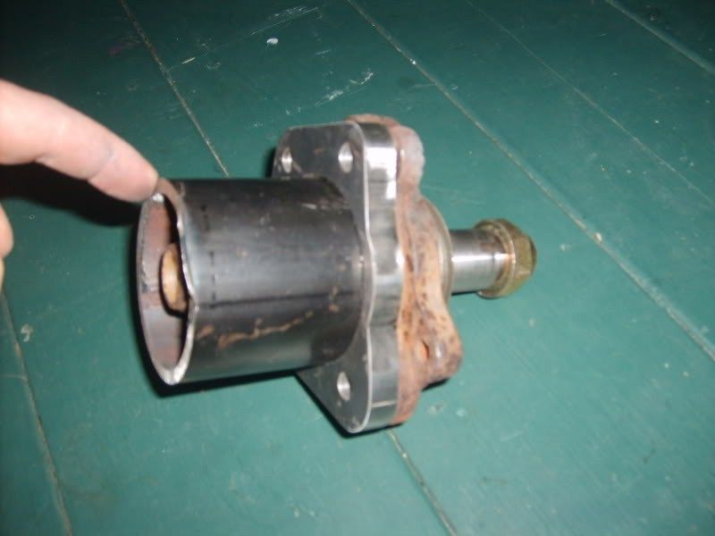

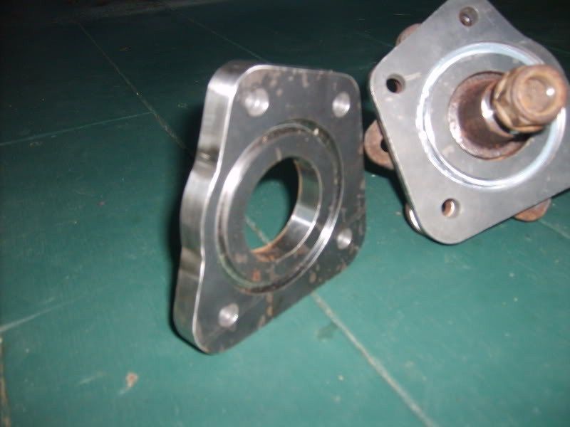

I dont know if you know of a good machine shop or are friends with a machinest, a friend and i were building a 95 civic for someone we know and ended up just building our own axle. Ended up being much easier, i just had a buddy of mine machine the ends and then welded them up to the tube. IMO its much cleaner looking then any axle you could pull form another car. Just unbolt you stock spindle in the rear and it all bolts in.
Here are some pics to help out some.
