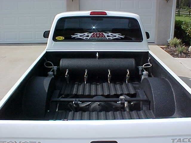

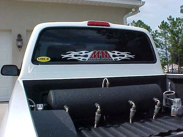

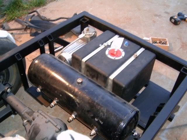

those valve come right off the tank... cant really see it though
isdeleon's avatar
isdeleon
two questions; 1) what are the advantages/disadvantages of having the valves close to the tank, 2) had any trouble with blitzluft valves? there the same ones i'll be using. nice truck by the way.
layedoutb2k (chase)'s avatar
layedoutb2k (chase)
one advantage of having valves on the tank is the ride is a little better. it adds volume from the valves to the bags so there is more air to compress. it also is a really easy way to mount your valves if they are screwed in directly.

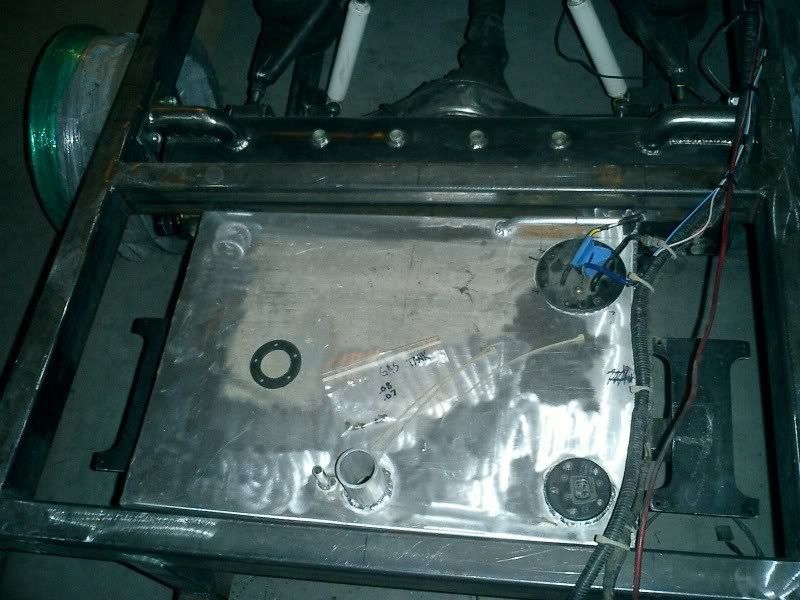

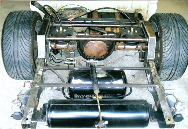

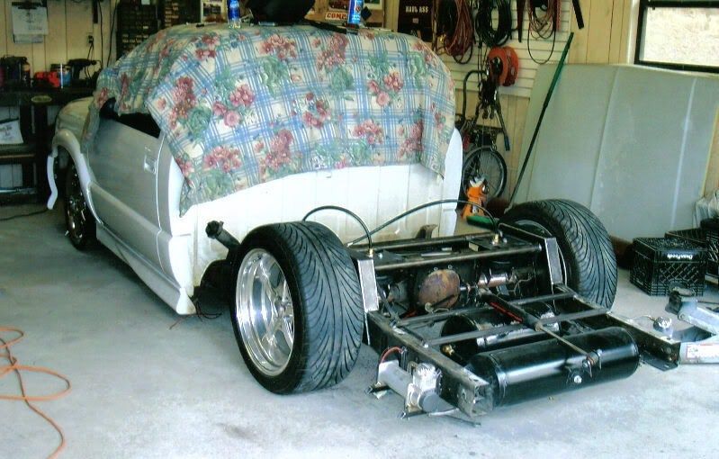

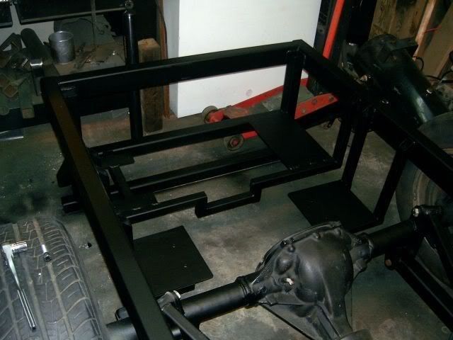

heres my new subframe im working on. kind of hard to see but my compressors sit on those mounts on both sides of the fuel cell and the tank is in front of the cell right behind the rear axle.. the valves will go right there on top of the tank as well

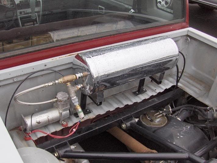

another question, does it matter if i put the compressor below the thank? i'm worried about water going from the tank down to the compressor. might this be a problem?
unusualfabrication's avatar
unusualfabrication
Run water seperators between your compressors and tanks.
