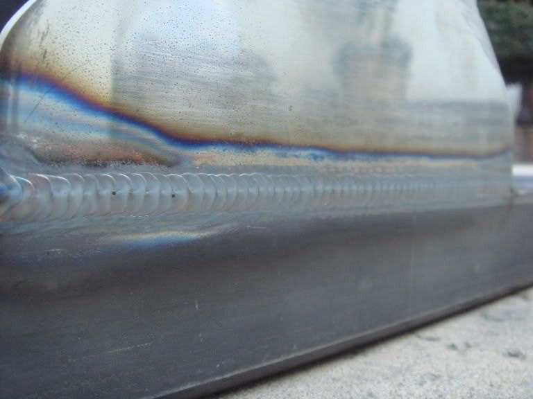

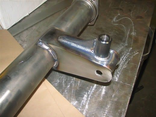

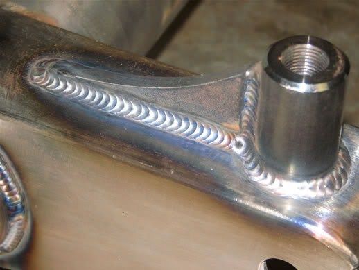

they key to a bitchin weld is consistency consistency consistency. the more consistent you are, the better your 'dimes' will look. things from holding the trigger the exact amount of time each weld, to moving at a constant speed, it all comes into play. change one thing, and it will come out looking different. i TIG weld most of my stuff, just because of the overall appearance of it when its done.

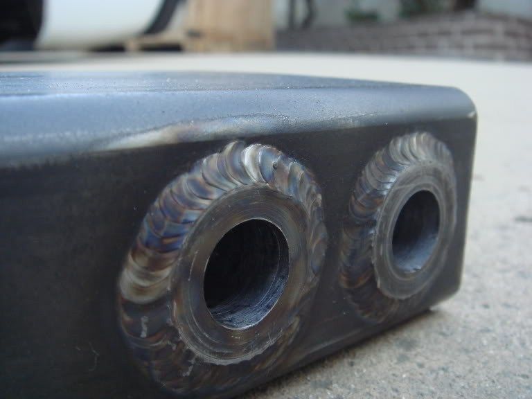

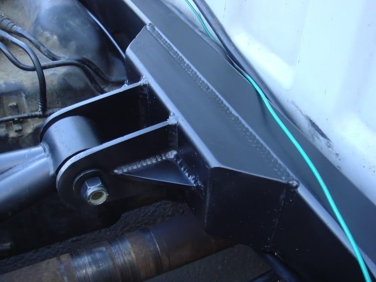

heres my axle for my 68 c10. triangulated 4 bar, with link mounted bags. the pics are of the lower parallel links, with a bung tapped for a 5/8" bolt for my lower shock mount. note the welds...

WOW...that looks awesome. do you move at one constant speed, or move the weld then pause then move then pause, etc? do you move the gun in "c" shapes or circles or what? because my welds are consistent and penetrate well, but they look like one solid bead and not stacked beads like yours above. i know a MIG weld won't look as clean as that, but still.

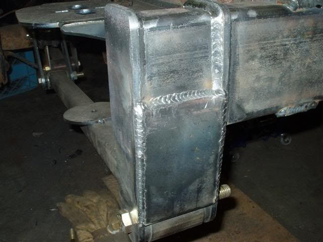

speed... i get my puddle going, then once its the right size, i add my rod, and then 'hop' to where the next puddle is going to be. this 'hop' is important because it needs to be the same distance each time or the weld wont look consistent. as far as the topics you mentioned earlier, theres no set answer as far as how to lay down a perfect bead. everything is taken into consideration, metal thickness, metal temperature, fill rod size, amperage, etc. the 'stack of dimes' is from consistency. adding the same amount of fill rod each time, moving the same speed, staying in one spot for the exact amount of time over and over. heres some more pics

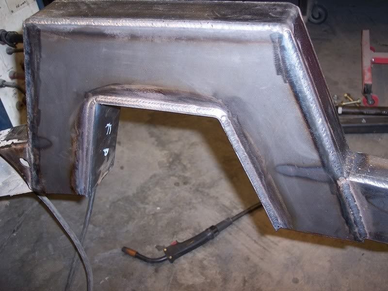

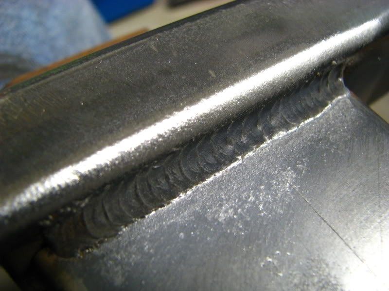

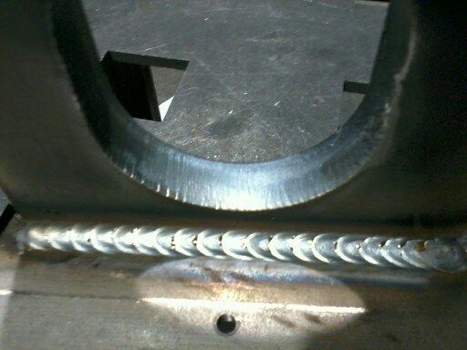

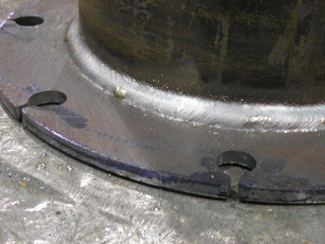

heres a crossmember, MIG welded.
same crossmember, before paint, a little closer

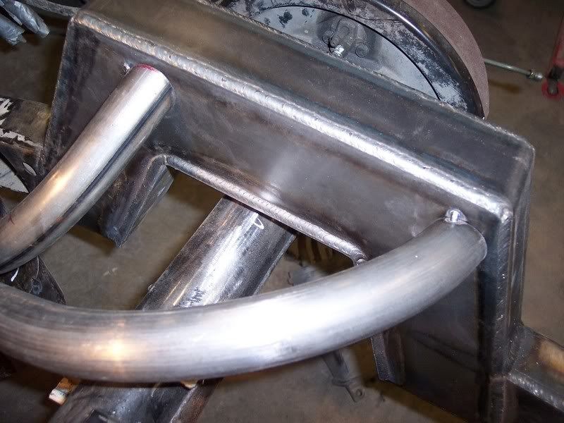

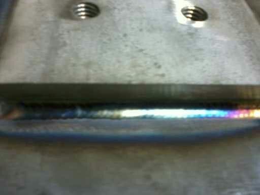

here, the round stock (1 1/8" diameter) was protruding 1/8" out of the 2x4. not much to weld to. used .045 tig rod and tried not to melt away the corner of the round stock

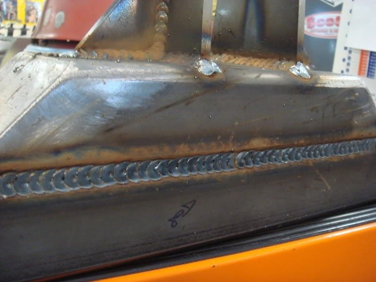

here, kinda wavy because of all the fill rod added due to welding on the round corner of the 2x4.

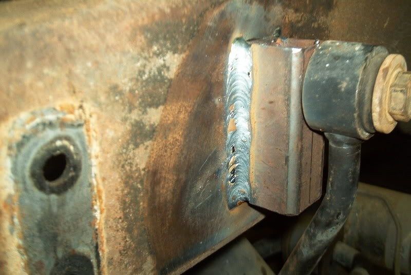

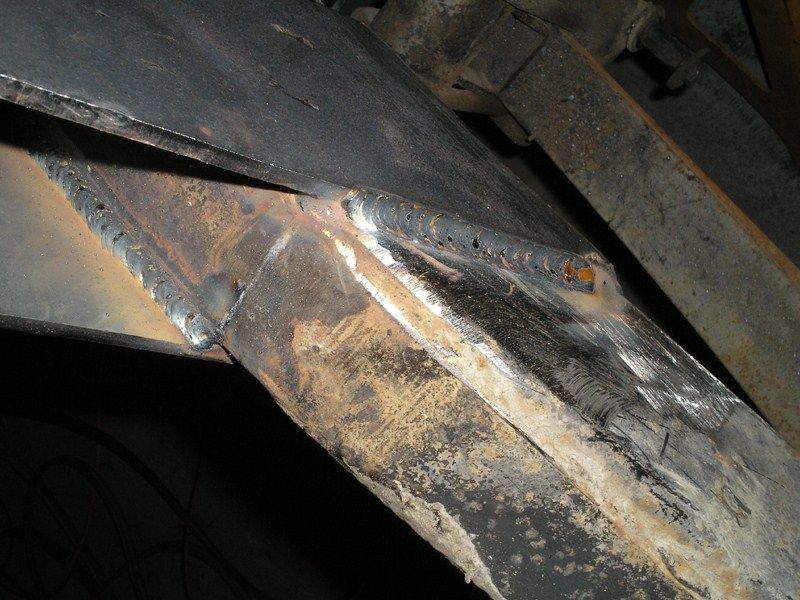

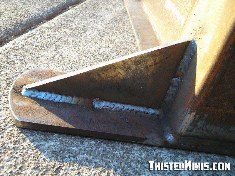

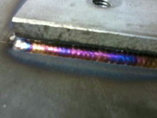

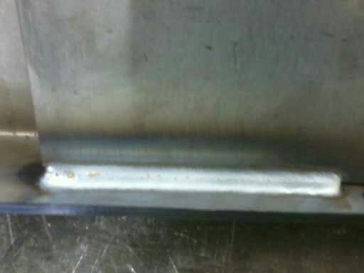

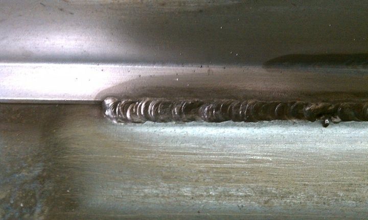

Recently I played with the effects of different techniques on one piece. Look at this picture.The vertical weld is the traditional C pattern. Although vertical, it looks more like a lower case "n".
The next weld, going from the vert weld to the center of the gusset is the circle pattern. I was moving to the left, and rotating the tip counter clockwise.
The last weld that extends to the end of the gusset, is also the circle pattern. However, I was rotation the tip clockwise, while moving to the left. This is my favorite pattern. With a little practice you can simulate dime like beads. The general rule of thumb for this, is when moving to the left, clockwise rotation. When moving to the right, counterclockwise rotation. Making circles, and overlapping them generally looks something like an "e" like stated above.
