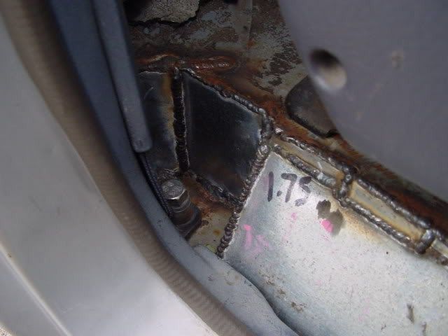

the body mounts are in the foot well and in the back cab corners by the door ive got like 4inches im going in to angle it my boy had a nissan with a 6 3/4" bd that went straight up u wanna talk about a step heres a pic deffinitely not something i want
