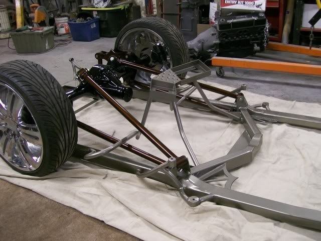

this is the under the axle frame we built

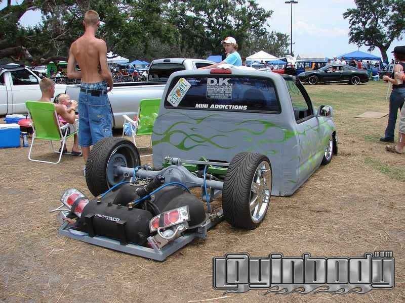

SPICY
i like my under axle set up it works well the larger the wheels the more lift

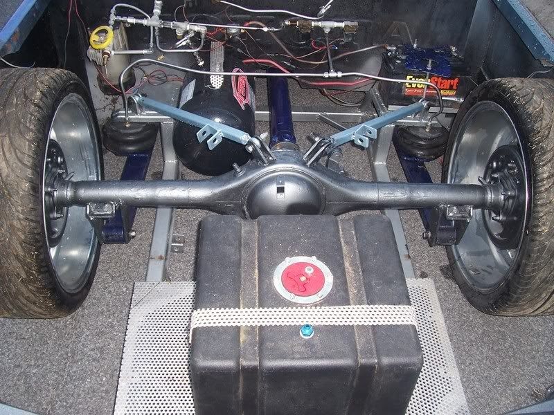

SPICY
heres another one we did
