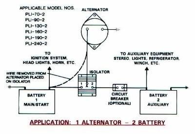

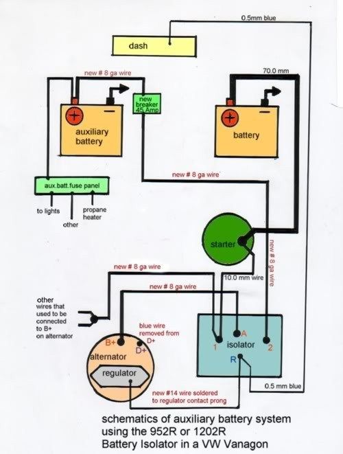

i want to wire in a second battery. i see those battery isolators but how do you wire it in? which wire is the ignition wire? is that the one from the batt to the starter? (smaller guage) thanks.

the ignition wire is one that comes from your fuse box thats only hot when the truck is on you can use a wire from your radio also
