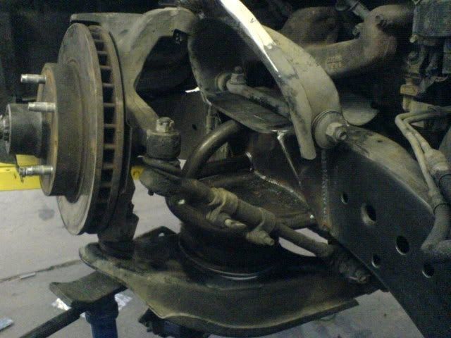

i found a pic on here that someone did it. it will act like a drop spindle give about 2 more in of drop i would think heres the pic

that would totally destroy all steering angles and kill the front end. It looks like he flipped the spindle as well. I wouldn't do it, most balljoints are made to be used in tension situations not compression like flipping them creates.

just buy belltech's spindles...
