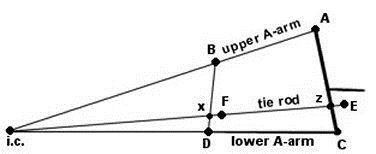

Not quite. It depends on where you mount the rack in relation to the upper and lower bars. If the rack is mounted at the same height as the lower control arms then yew, the rack and lca inner pivots should be in line with each other. But the higher up the rack is mounted the more it needs to be related to the upper arm too. I would never build around a rack unless I was on an island and couldn't get something different. But, I would design my front end with the rack in mind.
This is the basic diagram used to calculate steering placement.

Ive read your diagram and I have a fairly good idea of how to set the rack up... Im just having a hard time finding A rack for my set up. Im just asking what is a ideal sized rack I should look into. Im probably goign to base my measurements off a yota clip. Any ideas?
