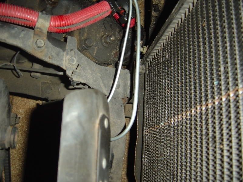

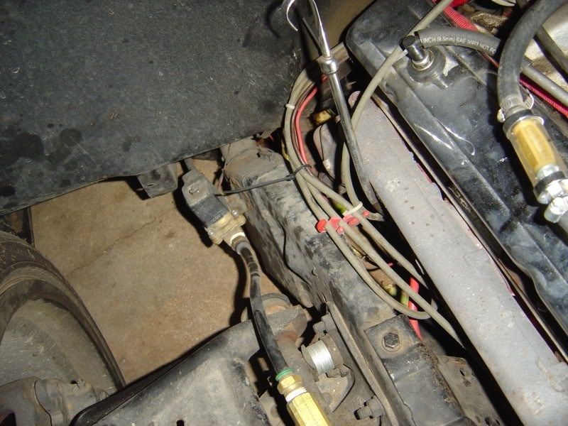

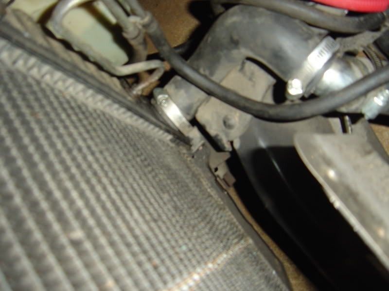

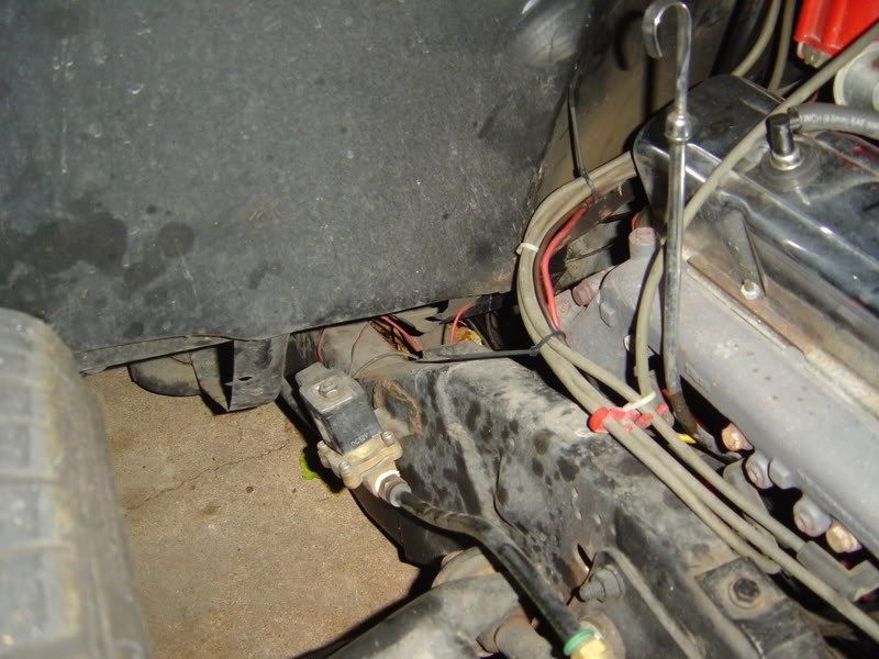

My 78 is z'd and it's the same front suspension. I'll snap some pictures tonight and post them up.
domepiece
I didn't do the work on mine but here's some pics of it. I think it's about 2.5 or 3 inches but not sure. You can also section the front crossmember and get it to lay frame all the way. i plan on sectioning mine just to run bigger wheels later on. Here's the pics.

Thats a hefty stack of washers you got there.
no1lowr's avatar
no1lowr
domepiece
I was wondering if someone would notice that. The allignment spacers kept falling out and coming loose. I put grade 8 bolts in there and the washers. It sucked getting the allignment close. I had to remove the entire arm to remove or add a washer and put it all back together again numerous times. Works great though.
