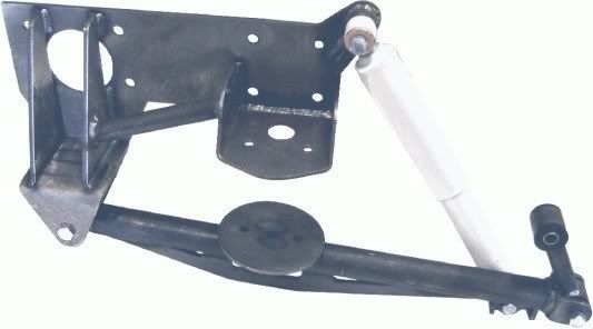

run two bars backwords with a shackel on it so it dosent bind. heres what a kp looks like.
