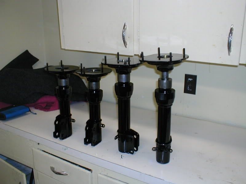

6 or 8s in the front run regular cylnders reverse are junk,,,and run accumulators no mini coils,,,i can show you pics of a strut housing i make that works perfect,,or go to www.myspace.com/illicitcustoms i think there is a pic there of the honda strut

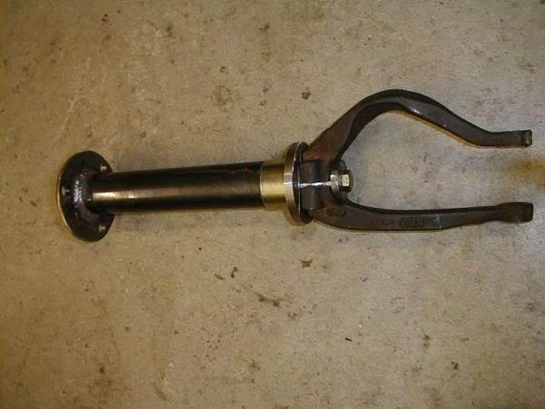

Do you have anymre pics?
I am learning about hydros. Is the cylinder inside a tube welded to the top mount or is that the cylinder itself? Where does the fluid enter?
Thanks
ahab's avatar
ahab
The piece that is welded on is just a tube that the cylinder is slid into. The fluid goes in the top

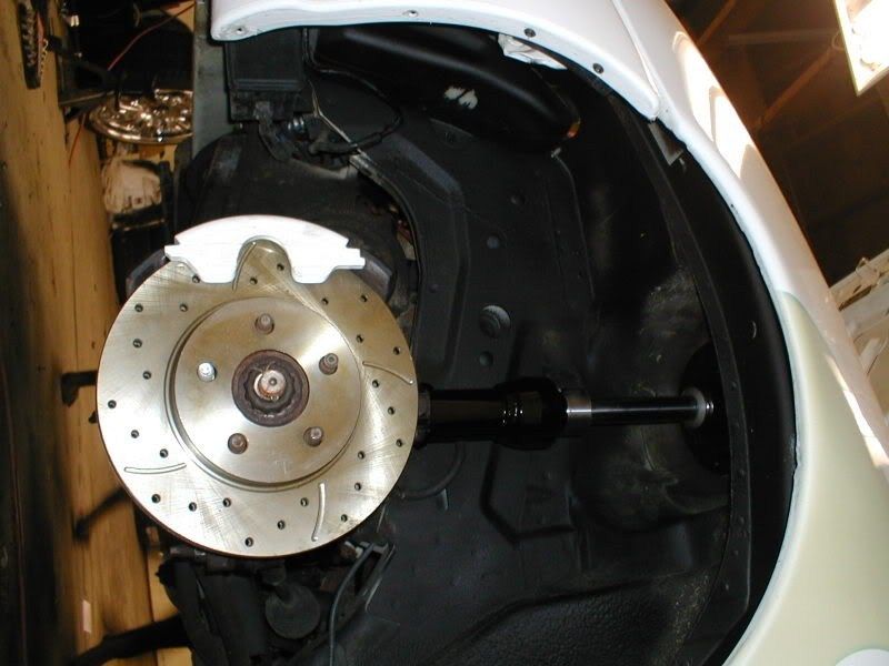

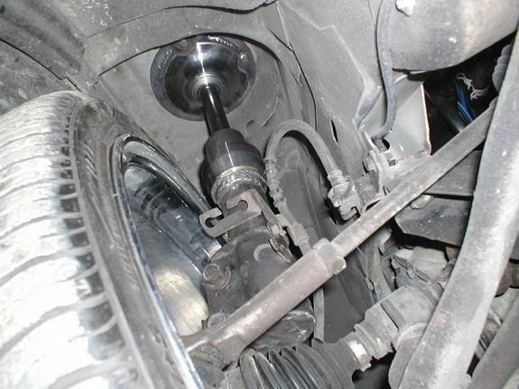

is that all it takes to get a cylinder in the front of a honda? just wanna know since im considering juice for my accord
