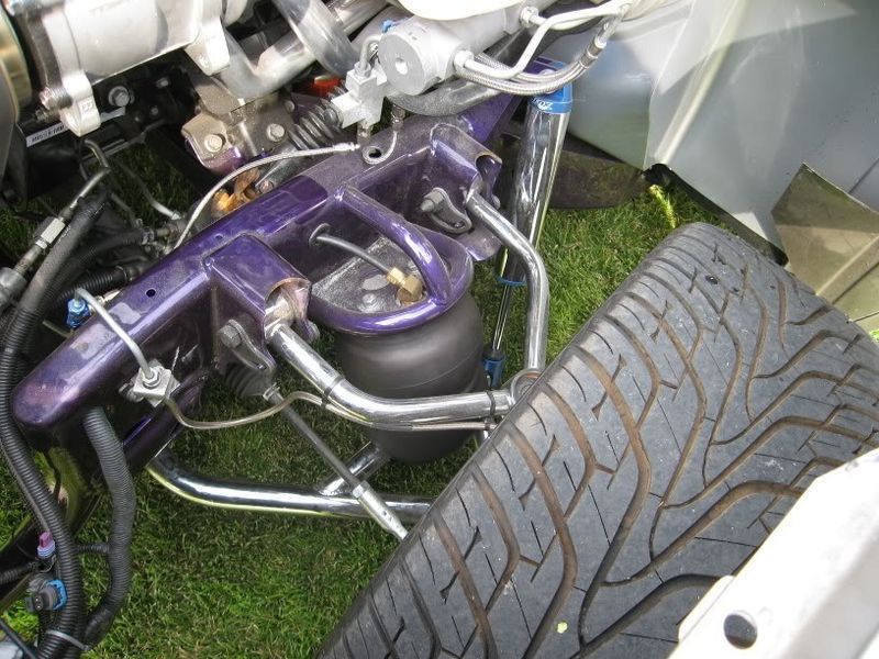

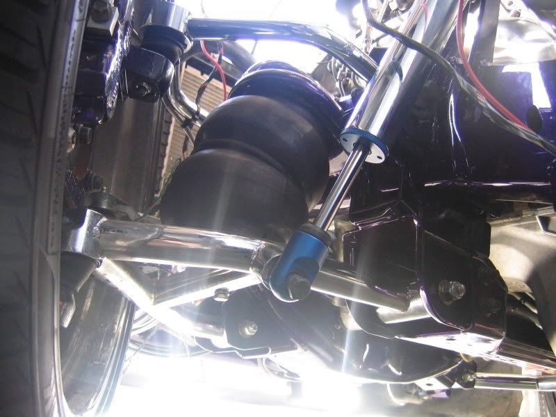

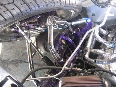

I look through the owner profiles, but could not find any good pictures of the front suspension. I am curious what others are doing with mounting the shock. If you have any pics of the front set up, please post, thanks

Shocks are a big deal on these trucks... On this suspsion design, the travel of the wheels go positive-negative-positive (camber) alot more than other GM trucks... With no shocks up front, u will notice alot of wear on the inside and outside of the tires...
phat phabrikationz's avatar
phat phabrikationz
I mount them in the usual place behind the control arms, damn near straight up and down as close to the frame as possible...

mine are mounted right next to the uca bolts straight up and down
