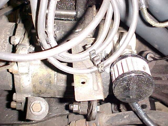

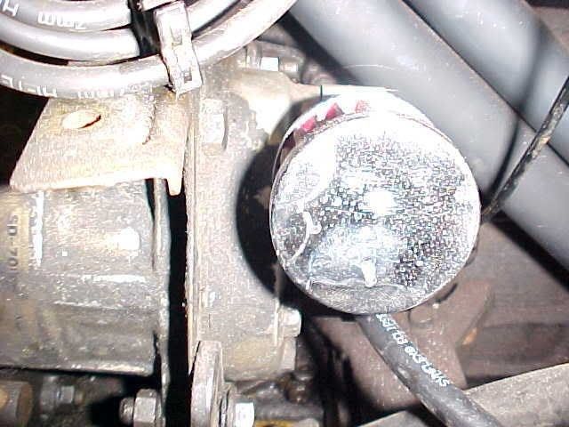

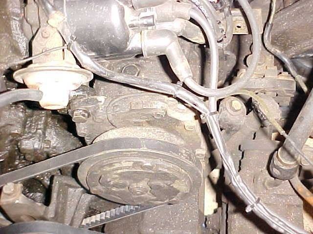

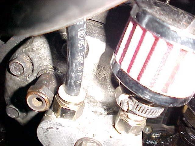

I just used my factory compressor. All i had to do is just tap the ports to accept air line, And throw on a check valve to keep the pressure off the pump...Mines a B2000. But it works fine and is actually impressivly fast.
2600air
Ferret Ive got a stock compressor but did you have to put a oiler on yours.
karathos's avatar
karathos
Edited: 8/31/2007 10:07:04 AM by Karathos
No my compressor had an oil sump already in it. Some of our compressors are set up that way, Some are oiled through the refrigerant. Have to check yours to make sure...
Here are a few bad pics of mine....
