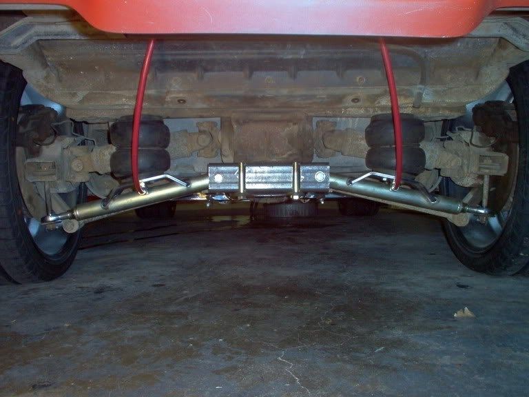

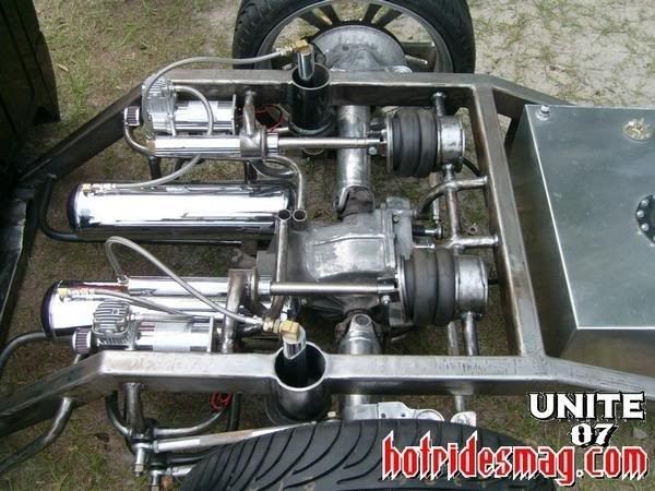

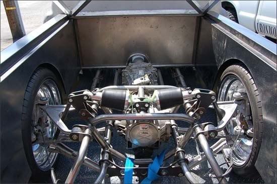

you could cantilever it, heres one picture of how Ironworks Speed and Kustom in Bakersfield, CA did it on their 57 chevy truck...they can be mounted facing forward too, dont have to be going side to side. this rear end may be a little different than what your using as it is a c6

I don't know how much help this will be, but it may give you a basic idea.

thanks Kevin, I believe that is what max is talkin about. Do you have anymore pics?

That's the best overall pic of the set-up. Here's one of the bags mounted on the bars...I tried to keep it all as simple as possible, in case I wanted to go back to the leaf.

that vette rear posted above is a transaxle, they are different than the one like he is talking about.....
bdroppeddak's avatar
bdroppeddak
the first one posted......
