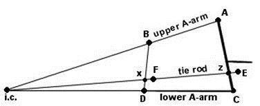

Rack or box, the geometry is addressed the same way for both. The only difference that we are concerned about here is that the rack houses the inner tierods, where the box drives a center link with the inner tierod mounts on it.
Proper rack placement depends on where the inner tierods should be. The biggest problem with racks is that the distance between the inner tierods is set by the rack so you need to order a rack with the right inner tierod width. Height placement needs to be calculated with this diagram
and front to rear placement needs to be calculated for ackermann. (See the sticky)
Racks can really be a pain to get in the right spot and/or find the reight width. The only rack car I have ever done was the Chevelle in my profile and I had some fun finding the right rack for my aplication.
